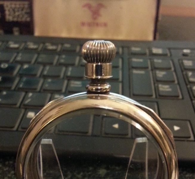

Bought and received this display case from on of our colleagues here. It is very nice.
But the purpose of the groove in the neck eludes me. Did these hang on a forked hook? Did they have some sort of clamp on bow? Were they mounted in some fashion so they could be rotated for display?
Every thing has a place, every place has a thing... this place is missing it's thing!
October 11, 2014, 11:16
Buster Beck
I believe that's just part of the design[s] concept on all of the tall pendant cases. Most had to be "meatier" above the thinnest diameter or "groove" part in order to allow for the "ears" or holes to be drilled for the bow, even though ones like this one weren't designed for a bow. I believe having the same diameter from the base to the top would not be quite as appealing to the eye as in the "hourglass effect". Like a women's waist/figure, the eye picks up the curves !!
Even if they had of been made the same thick diameter from base to the top, they would still need to have the internal smaller diameter "shaft", guide/groove in order to help keep and align the stem straight.
Along with a thicker section above the groove for a bow to attach to, without a bow as in this case, you still needed the thicker diameter to allow for a possible sleeve to function and operate and/or the screw down dust cover that some cases had.
Design, eye-appeal, and functionality can be sighted as to why a "groove" IMHO.
All in all I believe it was an acceptable design/industry standard adaption that worked sufficiently on 95-98% of the movements to be cased.

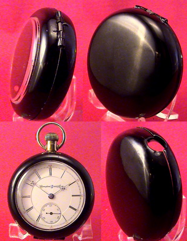

The "aftermarket" made very good thin flannel-lined 'clamshells' to fit that deep groove and help protect the early Pillar Plate movements from sharp temperature variations . . .
