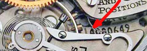

December 09, 2012, 16:58
Edward L. Parsons, Jr.
Here's the wire in "brake released" mode on a 4992B:
