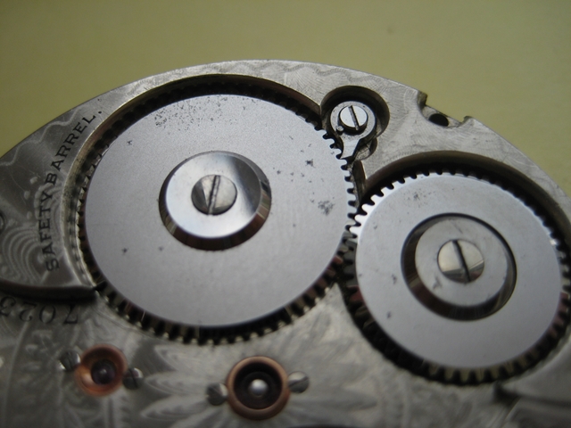

Waltham `92`main/ratchet wheel markings.
I guess we`ve all seen the intricate plate damascening on Waltham 92 models, but how about the main/ratchet wheel markings. You can virtually identify the grade from these markings as they`re all different - ok, you can get the odd same markings with two different grades occasionally. And we all know the Vanguard grade from its plain machined wheels.
But, has anyone seen frosty type finishes on these wheels ? I found some the other day which I`ve never seen before. It doesn`t look like they`ve been tampered with, just plain frosting.
