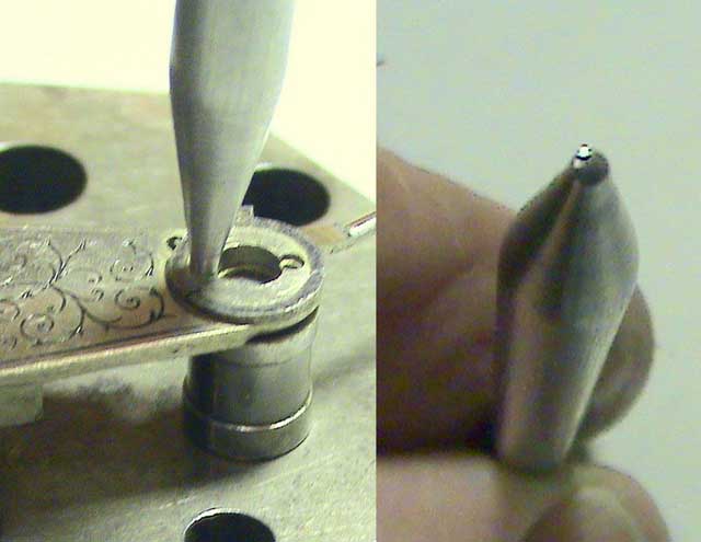

David AbbeWhen I have a stripped Jewel screw, I take the near smallest ball tip stake, and a "stump" and using my Watchmaker's anvil for suppport, I
LIGHTLY strike the top of the stripped hole so the ball end compresses the hole enough to accept the thread again. This works 99% of the time (for me
WARNING!, if this is struck too hard, you may need to scrape out the Jewel pocket, so be careful try and test, try and test . . .

I agree with both David and Lindell.  Compressing the soft metal to decrease the thread diameter, very carefully and just as Mr. Abbe describes, is the best option.  If the outer material will not shrink sufficiently to accept the screw, I think a good adhesive is the only option.  Both cyanoacrylate as well as 2 part catalyzed epoxy, which is also a good option in this case, are removable through boiling in water.  So no permanent harm will come from doing this in my opinion.
