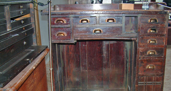

My black walnut is in my watchmaker's bench (see picture).
My Bench Smile
October 08, 2010, 00:06
Tom Brunton
now that puts my old oak beater to shame LOL
