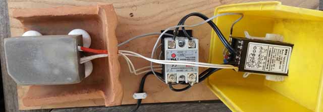

Dan CarterGood luck Lou!  It is pretty fun, just follow Harold's instructions and you should be fine.  Thanks again Harold for this great idea!  Here are some pics of the components and how they are wired.  Note the red wire is one that I had as spare.  It has silver wire, and is smooth.  The top red wire is to the cartridge heater.
November 30, 2013, 17:06
Dan CarterNote the red wire on the top is to the cartridge heater.  The two white wires on the left are to the  power plug.  I marked the bottom one black like in Harold's post. Please note that in Harold's post / picture, the 3 goes to 3, and the 4 goes to 4.  In my case because of the relay I guess, they are switched.  My relay counts clockwise, rather than sequential.  As a result, mine had to go 4 to 3 and 3 to 4.

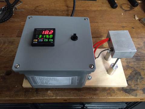

Shawn WaldermanThanks for the idea and plans. Made the bluing machine with a block of aluminum and it works so well. Must remember to remove nickel plating or screw will not blue. Took a little while to set alarms properly for good function. Thanks Dan for the wiring correction, seems I have the same relay.
February 08, 2014, 17:34
Phillip SanchezShawn your image was much too large to be viewed properly. I have resized it.
Good job with the bluing machine.

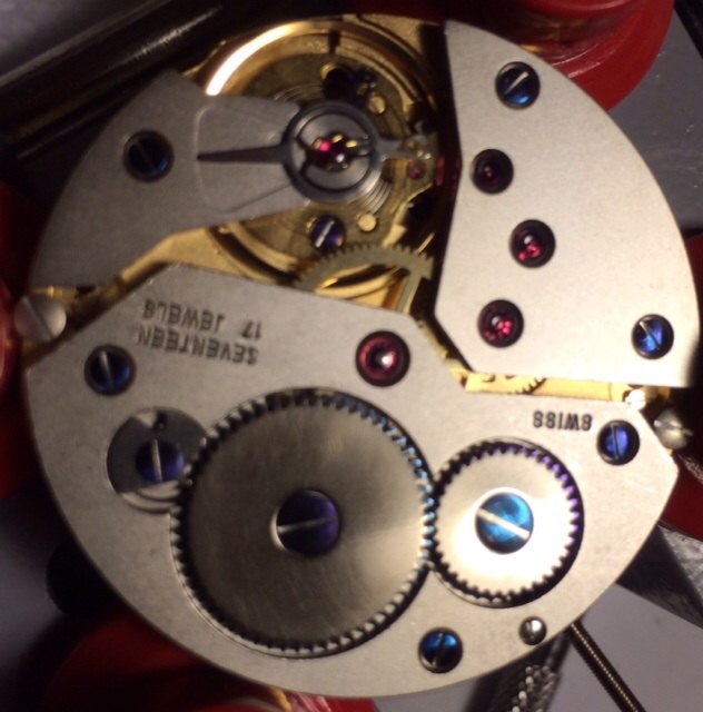

Dan CarterGlad it worked out!  I find that sanding the screws in one direction seems to work better as well.  I tried circular motions but had no luck.  I usually sand 800 grit sandpaper if I need to break up rust, then 1500, then 2000.  This little machine/project was well worth the investment and effort for me.
Here is an ETA 6498 that I blued the screws on:

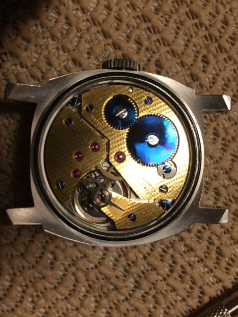

Dan CarterI usually use some of the 2000 grit sandpaper (a small piece) and either use an eraser to hold it, or a glue it to a toothpick to sand the minute hand center hub.  Now, I decided to move on to something a bit larger.  If you look at the ratchet and crown wheels of my last post, you can see a bit of blueing on the teeth and around the edge, like a small blue halo (customer LOVED it).  I decided to try the whole wheel on my Panerai Homage.  Took me a long time, and it still is not quite even, but it added some serious character I think.  I will repost the picture here, I posted it to another area, but think it should really be in this area.
It looks almost oily here, but when the light changes, it gets a deeper consistent dark blue.  Take a look at the
other post.
