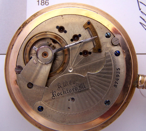

Can anyone offer up any info on this 15j Rockford. Swapmeet find yesterday.
Aaron
June 06, 2005, 16:58
Ed Ueberall
Aaron,
From the serial number, 274,935, this looks to be a Model 8, Grade 83, 15 jewel, HC Mvt, lever set and pendant wind.
The only thing I question is that the damaskeening on the barrel bridge does not seem to match that on the train bridge. It might be a good idea to see if the serial numbers on the pillar plate and the train bridge match that on the barrel bridge.

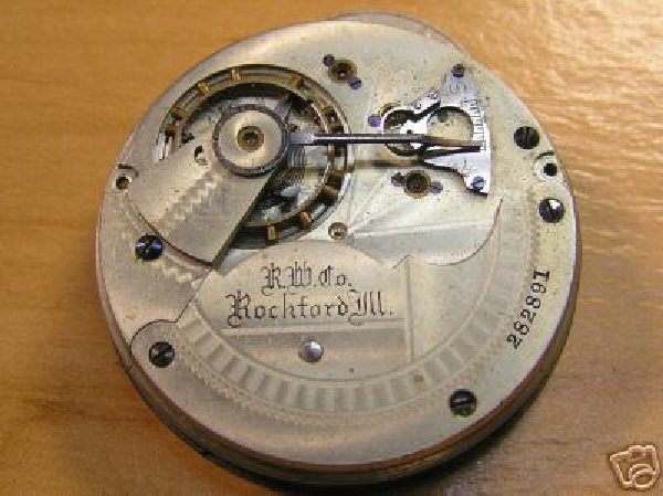

Here is a similar movement. Looks like the barrel bridges and balance arms were randomly chosen.
When I can get the chance, will locate movement and check serials.
