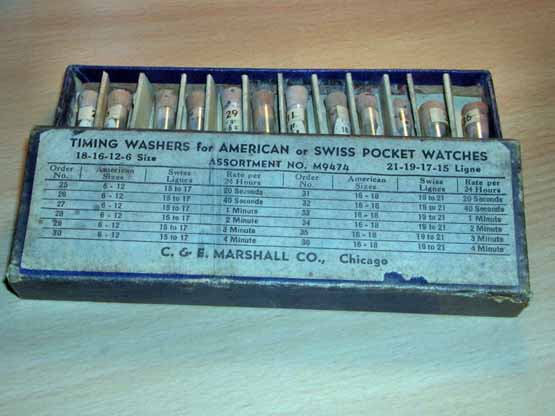

Hi all, I just acquired a complete set of pocket watch timing washers covering size 6 thru 18. Boy are they tiny. They are all made by C&E Marshall and are metal, and the vials still contain lots.
The box has a chart and when I add one washer to a timing screw I have to add the same to the opposite screw. On that chart it shows that by adding one washer the movement slows down by a given amount.
For example if I add 1 number 36 washer in 24 hours the watch looses 4 minutes. That seems excessive doesn't it?
I'm amazed that you can play with the timing that much. I got the washers so I could wind in some of the timing screws that right now are turned out from zero to say 3 turns as the movement was running to fast for the regulator to compensate for.
Luckily I've only got about 4 movements that I'll install the washers on.
R. Glenn

Hi David. So those are the screws at the end of the yoke and then 90 degrees to those, so 4 in total.
I thought that those were the only screws that you did adjust either in or out for timing and that the rest were for poising the balance.
You may remember about a year ago an Elgin BWR that ran way too fast. I ended up adjusting only the yoke screws and it now runs very close to RR in 4 positions.
That is one of the movements that I wanted to add the washers to that would then bring those 2 screws back in closer to the balance.
So do I have the use of timing washers wrong and they are only meant for the other balance screws?
Roland.

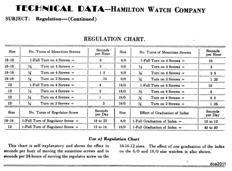

Roland, the timing washers work fine for what you want to do. I would put them on the first two pairs of balance screws nearest the mean time screws on the yoke so you do not mess with the temperatyure adjustments. Then as you have noted the watch will slow a little and you can compensate for that by using the mean time screws. I use the Hamilton chart for figuring out the mean time screw adjustment

Thank you David, very handy chart.
On this chart I assume for example that 1-full on 4 screws = 6 seconds/hr can go either way. Turn in and gain 6 seconds, turn out and loose 6 seconds.

David thank you the wealth of info I learn from your post. Is there any way you could email me a copy of this chart so I can download it. I have no found out to down load from the posts.
Thank you
Gene Buffard
genebuff@charter.com
March 01, 2011, 01:14
Gene, I tried unsuccessfuly to send the picture to your e-mail address; genebuff@charter.com
to save pictures directly from a posting in IHC185;
1. Put your cursor on the picture and right click.
2. Put your cursor on "save picture as" in the grey window and left click.
3. Put your cursor on the folder with a green "up" poiinting arrow at the top right of the listing window and left click a few times until "desktop" appears in the "save in" wiondow.
4. Hit "save"
5. The picture is now downloaded to your desktop.
