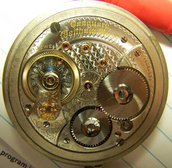

Mike HodgeBoth nice finds Jared. I particularly like the 1892 Vanguard. Did you get these locally and reasonably?

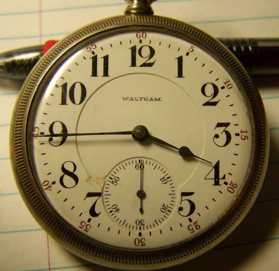

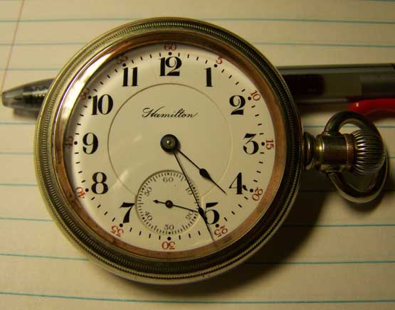

Mike HodgeThat's a very good deal as compared to ebay for example. The dial on the Hamilton is worth a goo 100 and the Waltham dial can be replaced reasonably if you choose to do that. It's not bad as is, but could be better. Both nice watches. Like I have mentioned, I have a couple scrappers who get watches for me. They are very inexpensive unless they are gold, but I don't get to pick and choose. Someday my ship will come in. I really like both of yours. Nice job.

I have found that the 18sz model 1892 dials generally call for a DSD and that the price of them is on the same level as the Hamilton line. The lower graded 17 jewel watches for the most part are found today with less than pristine dials because sellers have been "upgrading" these dials for 30+ years that I know of.
August 21, 2011, 13:19
Jared BrinkerBuster-
I have a couple chip and hairline free 1892 dials available. I may put one on it. I haven't decided if I will keep these two watches or sell them at the moment. I have both grades in my collection already, so I may see which is the better and sell the lesser! The wife seems to think I own enough watches at the present time, although I have a different feeling on that

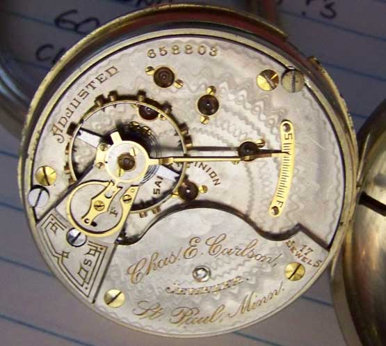

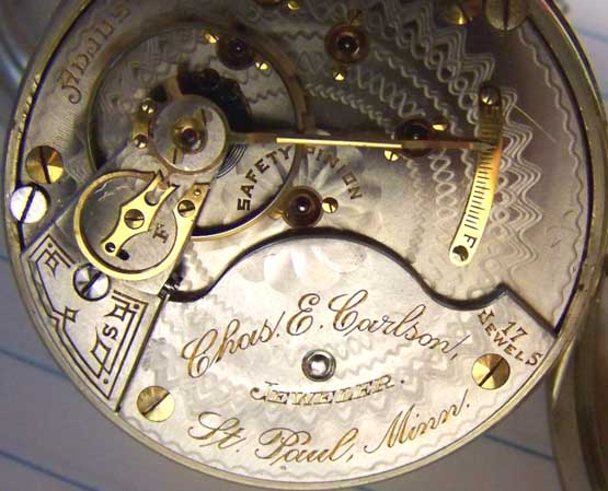

Jared BrinkerOk guys, since bth of these watches looked to have been taken care of and have good motion. I decided not to touch the movements in any way. I went ahead and timed them for 24 hours..... and the results are in! The Hamilton is 1 min. 15 seconds fast in 24 hours, the Waltham 30 seconds fast in 24 hours. Somebody took very good care of these two watches.
August 22, 2011, 08:11
Mark CrossPardon me, but they sound like they're in the need of a cleaning. These watches are capable of railroad accuracy, which is 30 seconds plus or minus per week.
When they run fast, especially THAT fast in a 24 hour period, it usually means the balance wheel isn't doing a full swing, usually meaning the oil is gummy.
The Hamilton is the main concern, as I see the regulator is already almost all the way over to the slow side of the scale and it's still running that fast. You might adjust the Waltham out to time closer as it's near center scale. Without knowing it's service record, I'd be careful.
I'd suggest you not run them anymore until you have them checked out.

Mark CrossVery good and understood.
I'm just concerned that the Hamilton, specifically, is hard over to slow on the regulator and it's still gaining over 8 minutes a week in your test.
That's pretty awful for a railroad grade watch, created to perform the 30 second variation per week. That one I'd be very careful running much more before a cleaning.
The Vanguard, on the other hand, looks like it can be 'tickled' into compliance as it is.

Richard M. JonesNice watches and a good buy! The Vanguard is worth putting a better dial on if you have one available.
