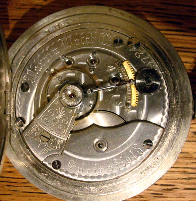

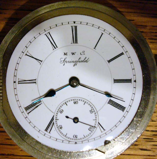

I was wondering if someone might tell me who the maker of this pocket watch is. It is a 18s stem wind lever set . The dial is marked M W Watch Co. & the movement is Marion Watch Co. Springfield.
I have seen where there was the Marion Watch Company but from what I have found their movements were marked Marion NJ.
Also I thought it odd that the disc next to the regulator that is marked adjusted covers part of the serial number.
Thanks for any help.

The Marion Watch Co. was the result of the reorganization of the United States Watch Co. in 1874. However, it was also the name of a watch produced by the United States Watch Co.
I have no idea which one it is, but it is a fine looking watch, and some of them are costly too!

Actually look closely at the movement. This is a Swiss Fake, and the name used is "MarVin" watch, the plate cuts are near the style of the Key Wind Thomas Studley style made by N. Y. Watch of Springfield, but the uniquely Swiss fake watch regulator is a dead giveaway. The fact is that as this is a working watch, it makes a nice "hi-Grade Marvin" Swiss fake, with a touch of Waltham in the Cock Foot cut, ad N.Y. Watch of Springfield in the copy cat plate cuts.

You are SO right!
I tried to enlarge the picture and couldn't, I'm so glad you can tell.
I also noticed that the Balance Cock was different and could not find a reference for it.
Great Information! I can mark that in my book.
Sorry Tom, not real up on these, but I sure love getting the answer as much as you!
Sheila

You are right about the Marvin, funny how your eyes see something that isn't there, I thought I saw Marion so I did, now it says Marvin & I don't know how I saw Marion. Oh well glad I didn't pay much for it & now I know what it is.

Considering the good condition of this watch, and the fact it is running, I would not despair it's ownership. It represents the poorly informed failure of Swiss watchmakers to "hit" the U.S. Watchmaker's market of high grade "made in USA" machine produced watches. To that end, take care of it as a piece of horological history which does have reasonable collectible value.

This one with a little bit of several makers thrown together helped slip it past buyers a hundred years ago and it still works! I agree with Tom, you can actually sit and look at the name and convince yourself it is right but then as David sorted it out and explained the specifics... it finally hits you! Eek WOOPS!!!
One of the best 'swiss-fakes' I've seen, it's worth saving.
Just be sure the whole story goes with it.

Not the one I posted, unless you got into my cabinet. Does your have the same serial number?

Yes-The serial number on mine is 972 and it looks just like yours. An interesting watch and thread.

Some of the Swiss Fakes are marked "Maroin".You see these once in a while on the bay.Regards.Norm
August 04, 2012, 11:48
Ray Hallenbeck
And many times they are marked with the same serial numbers. Confused
