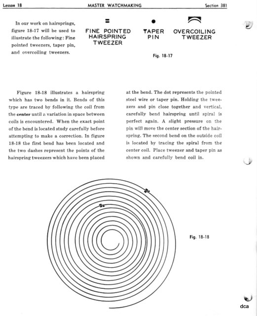

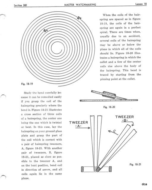

Mel, I have two good sources of Hairspring straightening. The first, from the Bulova watchmaking school presumed you had about 1,000 springs to practice on. A good idea, but less practical today. The second is from the Chicago school of watchmaking who in this lesson spent a lot of time explaining how Hairsprings were made, and how they replaced gravity for creating the "pendulum effect", then they showed how to straighten coil errors;
October 10, 2012, 22:47
and bent Hairsprings (below). The idea of fixing the three dimensional Breguet hairspring bends is honorable indeed, maybe Chris can pipe in with a primer on that . . . .
