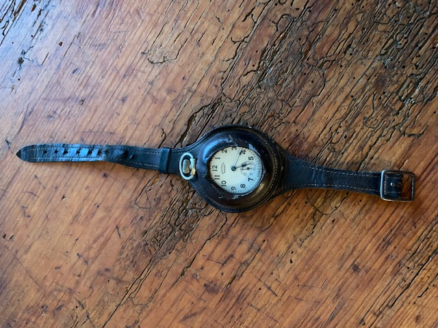

I’ve been idly looking for a size 12 watch suitable to make a wrist strap for - something along the lines of my circa 1920 Ingersoll Midget pictured below. I’m imagining that a 21+ jewel watch would be a good candidate: accurate, worth the investment and worth making a strap for. Are there a few of these high jewel count watches that tend to be available and generally serviceable? I suppose I am asking, what is the 12s version if the Hamilton 992b?

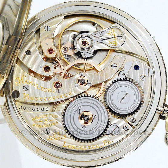

Joseph BlossicCoincidently, there was a post today of a serviced Hamilton 922 Masterpiece, I have attached with the owner’s permission.

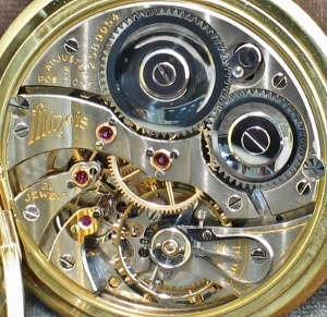

Ethan LipsigMark, your regrets are understandable. Illinois 409s are scarce (only 1,150 were made), high-grade beauties. Here is the movement of my 14k Knapp-cased 409.
June 28, 2021, 13:23
Mark CrossSigh. Yes, I remember. Gorgeous movements, and REALLY accurate!
