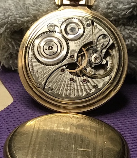

Bunn Special 16s sn 5305879 ‘23 Sixty’
Watch runs a few minutes then if I nudge the second wheel it runs again for a few minutes. Brisk and high healthy amplitude. I had the train bridge off, cleaned the pivots and jewels. Had the balance off, gave it a dip in hairspring cleaner. Cleaned and oiled balance stuff, demagnatized the reassembled watch.

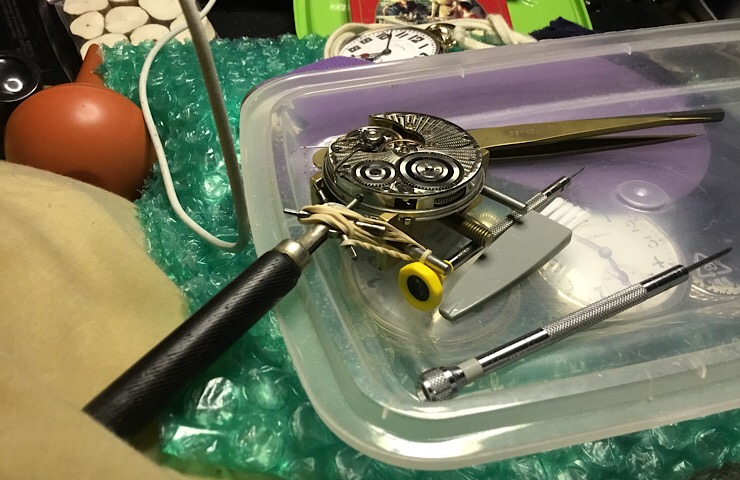

So I tried ‘adding power’to the mainspring with this rubber band holding the ratchet wheel on the verge of it’s next click. No Joy.

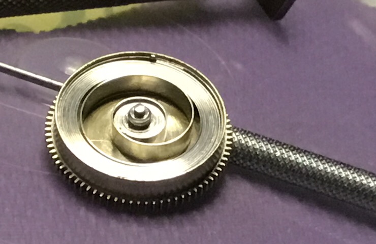

James ThormanWell I had to open the barrel and see!
This is NOT a blue steel old spring, that I can see. So this watch has already been fitted with what probably is a modern spring.
My question though is I can be reasonably sure the mainspring is NOT the cause of low less than 30 degrees of amplitude and a very fast running watch.
But I would like to know if this is recognizable as a ‘white alloy’ MS? ThankYou for the help!

Michael WegnerSo I'm just throwing this out there at the risk of being humiliated....but is there any chance the spring is dry and un-lubricated? (since it appears to have been replaced and other questionable things were discovered) Many a time I have hear my clocks "clunk" or even stop when a dirty or dry spring is involved, so it might be worth investigating.

Harry J. Hyaduck Sr.Mike if my sources are correct this looks like a white alloy mainspring and I was told you do not lubricate a while alloy mainspring. Maybe we will get some feedback on this.

James ThormanThankYou’s I had kind of figured by the color of the spring, NOT white but unbuffed chrome looking that of the available materials it could likely be alloy.
Sellers have said put them in as they come but if it is handled such as hand installing gloves are revommended. I read they have a silicon coating.

James ThormanGeeze I mixed up this thread! I posted the picture of the MS and barrel from a different watch. I apologize. That is an 18s BS not the 16s the thread should not have that included and I really messed up putting it in for this trouble shooting of the 16s. I think I should delete that! Or just disregard!!

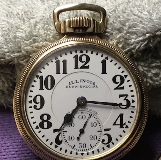

James ThormanHere is the ‘23 Sixty’ now straigtened and Happy to Run Run Run..
