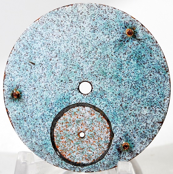

Aloha, I have a Elgin movement that someone has glued the dial on, probably because of missing one or more dial feet. Can any 185 member give me advice as to what to do with this situation? Soak in acetone or would that loosen up the pallet stones. Any guidance would be appreciated. Mahalo, Fred

Peter KaszubskiBeen in situation like yours myself I was fortunate enough to pry off the dial with out doing any damages to it I used screwdriver under the dial and very slow and softly pry at the location of the legs and my dial just pop out hope this help you but you might want to wait for others to give you better advise .

Fred OrrAloha Peter, thank you for your information and advice. Yes, I will wait to possibly hear from others as to their experience with a glued on dial before I attempt to remove it either mechanically or chemically. Mahalo, Fred

Steven FordFred,
You should be able to remove the balance and pallets from the other side before you soak it in anything. I don't think any of the other parts will be harmed by soaking in solvent. All will need disassembly and cleaning anyway.
Good luck and let us know how things come out.

Billy KuhnUse One Dip Hairspring cleaner

Fred OrrAloha Stephen, Billy, and Kevin thank you very much for the tips on how to deal with this vexing situation. For your added information this is an Elgin Ball so it is worth solving this issue without damaging the movement (then look for a
replacement ORRS dial ). Maybe the best way to do this is to let the power down, disassemble the movement and soak the dial, pillar plate with the center wheel and canon pinon still attached to the pillar plate until the glue dissolves as Stephen suggests. I think I need some professional help as well but I am going to be patient and take my time on this puppy. Mahalo nui for the suggestions. Very much appreciated and please keep 'em coming...Fred

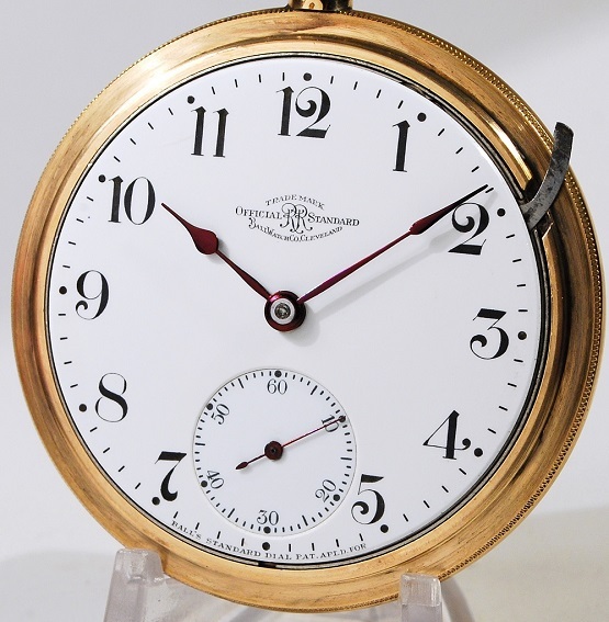

Fred,
If what you have is indeed an Official RR Standrd Ball-Elgin with the dial glued on, you have several issues.
Possibly whoever did that may have had a damaged dial or no dial and used a dial, perhaps from an 18-size Ball-Hamilton and since the dial feet are in different positions the scam-artist broke off the dial-feet glued a bogus dial in place!
Removing the dial is only part of your problem, the Ball-Elgins were produced for only a short period of time (circa 1904-05) and for that reason production numbers were very low... that means finding a proper dial is a difficult, some would say nearly impossible task.
If this is something you bought recently you might choose to invoke your "right of return" and bounce it right back to the unscrupulous seller who took advantage of you!

Fred OrrAloha Lindell, Thank you very much for your interesting reply and thank you for the important link. Very much appreciated. The serial number of this Elgin Ball is 12279108 (my apology for not including the serial number in the first instance). I do not have a replacement dial so I am going to have to search for one to restore this movement. Maybe an ORRS EB dial will turn up on Ebay. Unfortunately, I did NOT buy this EB on Ebay. I bought it directly from a member of the ***** who assured me that if I was not satisfied I could return the watch but reversed himself and would not allow me to return the watch for a refund when I advised him I was not satisfied. I consider the incident tuition at this juncture. Again, thank you very much for your post. It will be interesting to see if anyone else has any ideas for the removal of the glued on dial. Mahalo nui, Fred

Fred OrrAloha Lindell, thank you for your post and your sincere and precious concern. I appreciate it very, very much. Please allow me the privilege of updating this "glued on dial" matter. I had already sent this vexing watch to my "watch guy" before receiving your post. As he reported to me, believing that the dial feet must have been removed, working very carefully with a small screw driver (with great skill) and starting at the location of each dial foot he was able to gently and carefully "worry" his way around the dial, back and forth, very carefully wedging the dial upward until each dial foot (discovered that they were still there) became gradually more loose until he was able to free the dial from the movement without any damage whatsoever to either the pillar plate or the dial. And...surprisingly, all three dial feet were intact and undamaged. All three dial foot screws were not screwed in to the dial feet.
In the post mortem of this event it appears that someone must have been unaware of the existence of the dial feet screws (???), did not know how to fix the dial to the movement and decided to put a dollop of glue on each dial foot to fix it in place on the pillar plate!! I am at a complete loss as to whether this is the case or not: only speculating. In any event, after removal of the dial from the movement, all the glue was able to be removed from both the pillar plate and the dial feet so the movement can be serviced and restored properly. So, in the end, the prospect of the dial being damaged in removal was avoided by some very good luck and skillful work of my "watch guy" and I am pleased with the outcome.
Thank you to all (Lindell, Buster, Kevin, Billy, Steven, and Peter) who offered advice and council to me. At this juncture I am in a good place.
