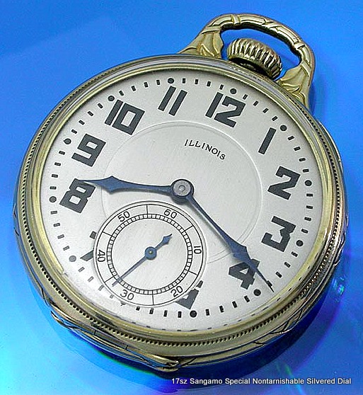

Buster BeckHere are pictures of what these dials look like.
Also RR companies accepted the metal dials. They were easier to read than enamel dials. They also added about $2.50 to the cost over and above the costs of enamel dials
Picture 1;

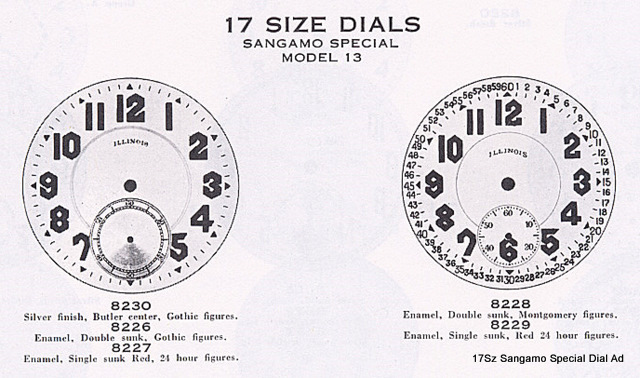

Buster BeckHere is a clip from an Illinois Parts Catalogue from 1930 where the metal butler finish dials as well as the DS Enamel Montgomery were available and pictured
Picture 2;

Sam HansenInteresting....I really don't find any oddness of the inner circle of the pictured butler dial yet the seller advised me that there were horizonal lines in the center of the dial on his watch. Maybe the butler carried the watch
That has to be the answer! Now it all makes sence. But I'm suprised to find that the railroad accepted the painted dials....good to know.

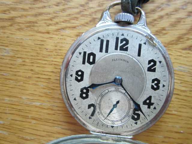

Sam HansenOkay....here's a couple photo's of the watch. I'm sure the dial is correct to the watch as is the case.
August 06, 2011, 04:11
Sam HansenThe dial shows vertical "brush" lines in the center.

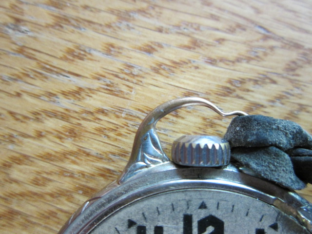

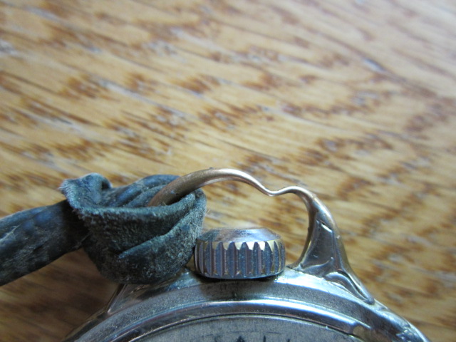

Sam HansenI was all set to buy this watch as the case, movement and dial really are not to bad....but when I moved the strap over here is what I found!
August 06, 2011, 04:19
Sam HansenAskin price of $700.00 but the bow is just too worn! When I pointed this out...the price went to $600.00 I pass...if anyone out there is interested let me know. I guess you could have a piece welded between the worn area and it would be better. Any suggestions?
August 06, 2011, 10:48
Buster BeckThe bow can be cast from a like example and the old bow can be cut off and the new one laser welded in place. Then it will need to be plated.
All of that will not be cheap. I would estimate between $300-400. The dial I would leave as is, I have seen much worse.
And change that seconds hand
August 06, 2011, 16:28
Sam HansenI did not purchase the watch as I stated above in the 2nd photo comment. I think a person could get by with just replacing the top part of the bow, cut it off and relplace it....not sure if it could be plated while on the case though. Anyway, its available for $600.00 if anyone wants it. Thanks again for all the comments!
