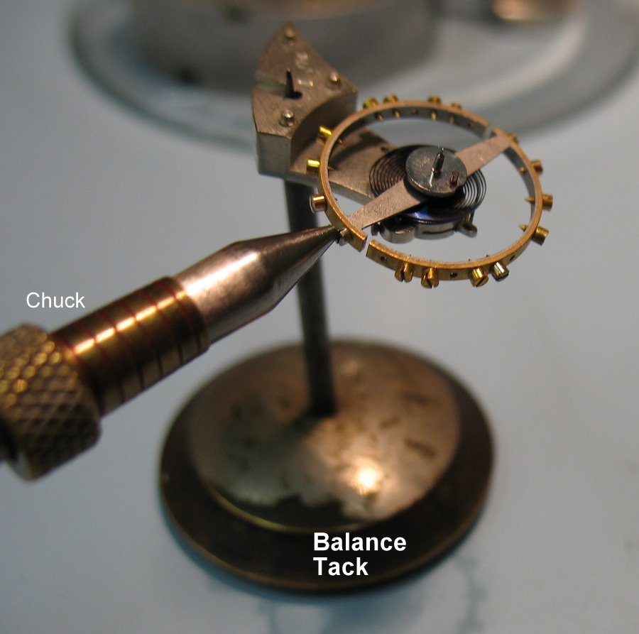

When I am timing a watch and want to make an adjustment to the MT screws without breaking the weights or stressing the staff pivots, I remove the Balance cock/wheel assembly, place it upside down on my balance cock tack so that I can carefully hold the wheel and turn the screws with my balance screw chuck tool.
(Please note, I am only showing what it looks like, the chuck is not actually clamped on the screw in pic as I had two to few hands to do all that and take the picture too.
