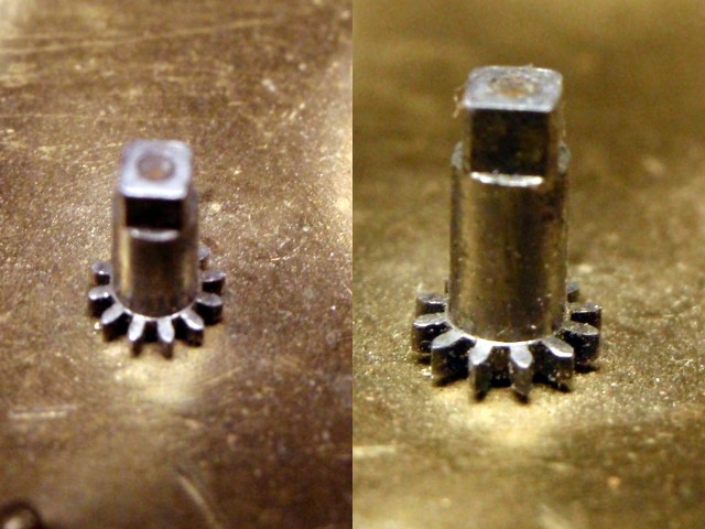

I took a couple photos of a Waltham key wind cannon pinion so you can see it is one piece, it comes off like any other cannon pinion but does not have to come off to remove the dial. I think your problem maybe in the mainspring barrel & not under the dial.
