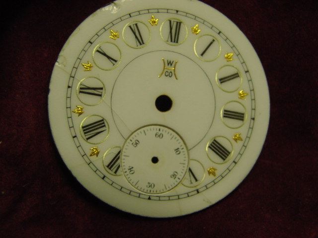

my friend has this dial and wants to know what Hampden movement it fits, and also he wants to buy that movement!! the dial is 1.800 inches diameter,45.78mm - Any info gladly received,Tom shame it is chipped and hairlined -what a lovely dial = center of hands hole to center of seconds hole 11.5mm Confused

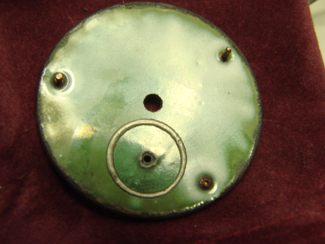

Having to "guess" at the foot positions Smile
it does appear to have feet at 14.0-36.4-51.9
So, it appears to be for an 18sz. and model 1, 2, and 4.
Fancy dials would not be appropriate on a RR watch, but would be appropriate on a gentleman's watch. I think anything around the turn of the 20th century would wear it quite well.
April 16, 2011, 18:20
Tom Brunton
Hi Buster thank you very much, and yes I forgot Confused legs are at 2:55,7:10,and 11:25 Wink
