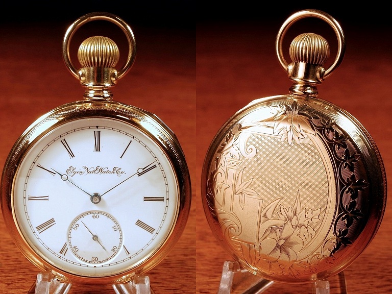

Eric Unselt
Paul, this is the movement from my 16s Elgin convertible.
Like Cecil said, the movement has a secondary winding arbor at the 3:00 position, making it possible for this watch to fit either case style and still have the dial alligned corrctly.
The black arrow is the winding arbor for open-face and the red arrow is for hunter configuration. The blue arrow shows the 4th wheel, the pinion of which holds the seconds hand.
March 12, 2011, 16:09
Eric Unselt
Dial and caseback:
