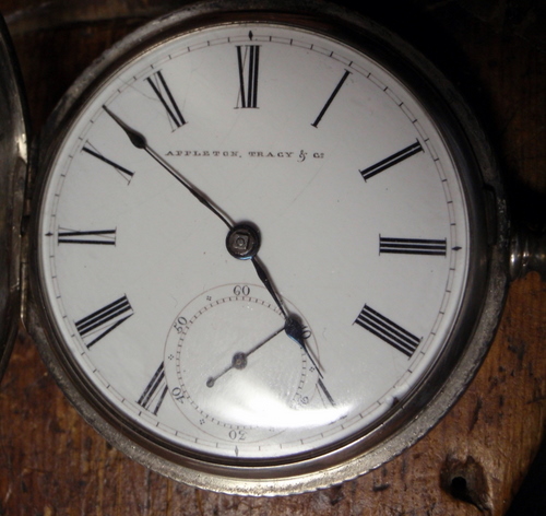

I bought a pre-Waltham Appleton Tracy & Co. Model 1857 PS Bartlett. I thought I would post a few photos of it.
The serial number is 8768, and dates the watch to March of 1858.

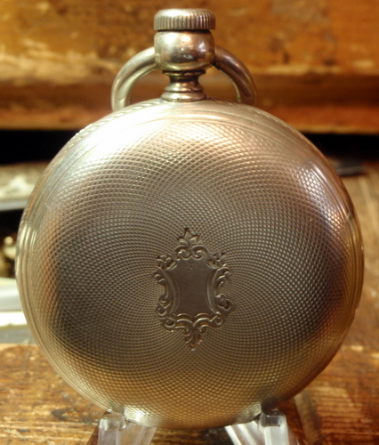

It has a nice engine turned sterling case, I made an earlier post trying to determine the maker.
https://ihc185.infopop.cc/eve/f...86047761/m/875102971
It is possibly a Mathey Bros., the case only has the one case screw mark, so I am curious if this was perhaps the orginal case. Brian had posted that they were in business inder this name from 1860-1880.
This is the front of the case.

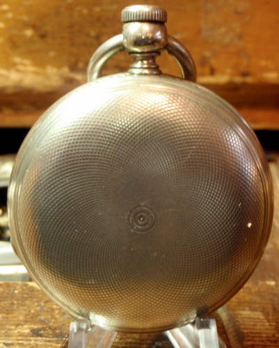

The case back

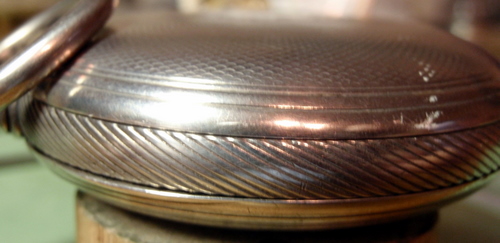

The case has a nice reeded (I am guessing that is the proper name) edge.

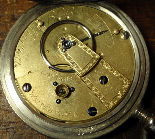

The movement is a pinned bridge & pinned dial, from what I have been able to find some say they made both screwed or pinned, the pinned was an attempt at money saving.
It is a 7 jewel movement, the hairspring is pinned under the balance cock, again a cost saving feature.

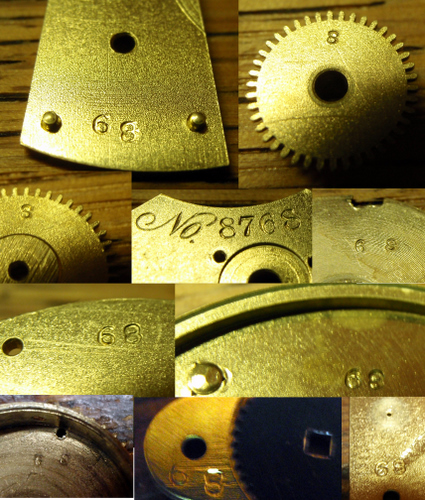

While taking it a part for cleaning, I noted that each part was number 68, the last two digits of the serial number. Even the minute wheel & the hour wheel were stamped with the number 8.
So I am assuming it is all original.
I want to thank Samie Smith for the new mainspring so I could get this up & running again.

That is a great watch! What stories it might tell! I've never seen one like it. Love those reeded edges, too! Eek

That's a real gem, Tom! What a find, especially in such nice condition and with matching plate numbers! You have a excellent example. Well done!

Your dial falls right in with the other data.
"Approx. August 1858 - AT&Co, straight signature, not sunk seconds")

I spoke with Chris Abell & I am going to send this to him to take a look at. The watch will run for a few hours & then stop, once I start it again it will again run for a while but then stop again.
As I mentioned the hairspring is pinned & I re-pinned it in the same position it was when I started but it runs slow in this position, if I crank the regulator up past fast I can get it up to 16200 which I assume this runs at. Since this is so early a watch & I have terrible luck with hairsprings I thought I had better have Chris look at it.
The one unusual thing I found, when checking the watch for any magnetism, I discovered there is a huge magnetic field around the mainspring barrel, it is so high that when a compass is brought near it the needle will completely rotate to the opposite pole. I have never seen this before but I know it can't be good for it's running ability.
I tried to demagnetize it but I think it is so charged it didn't make a difference. I would pull the mainspring barrel back out & check it but I found with these early watches the barrel will not come out with out totally disassembling the watch & since I am sending it to Chris I will let him take a look at that too.

I expect that Chris will and "Vibrate" and re-pin the balance wheel spring to tune it up to speed. Sounds like the mainspring has become a "magneto". Also, I suggest that you send the original hands along with it as Chris may have some "Watchmaker's alchemy method" to make that square hole a little smaller to fit again.
