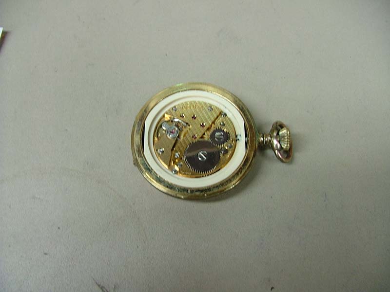

I have this watch and cannot find any information on it. Can anyone help to identify the age and quality of this movement? Thanks..Paul

Mark CrossThese were pretty popular in the 60's and 70's, and used Unitas movements. Most state they were pretty solid performers for the money.
Regards! Mark
April 28, 2011, 17:12
Krister OlssonThis is an average quality wrist watch movement most likely from the 70's. Good time keepers if timed properly. That, on the other hand, could be tricky since the regulator is not very accurate.

Paul ArsenaultCan anyone tell me how the stem is removed in order to get the movement out of the case? Thanks in advance for any help. Paul

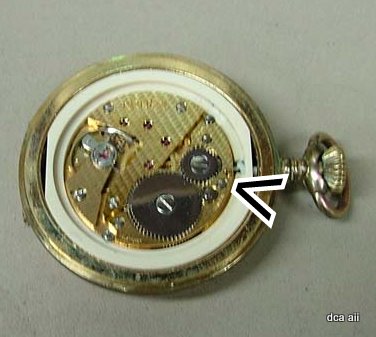

David AbbeIn answer to your question, USUALLY . . . these little swiss movements have a stem locking part that is screwed down to a detent in the winding stem and which (ugh
) have to be very carefully manipulated because if you mess up, you have to disassemble to watch to reset the locking piece.
That said, if you need to take it out (not to clean it please, these need a watchmaker) pull the winding stem out to "set", loosen the screw that appears to be near it (marked below) no more than 1-1/2 or 2 turns and the stem might come out. If it does not see a watchmaker.
