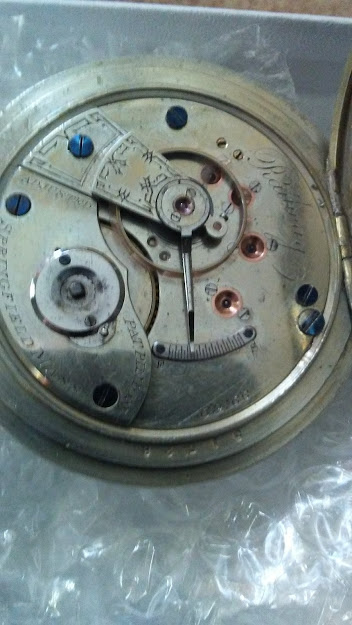

Kevin HoffmanEarly Hampden Railway - Keywind !
I have to show off my "new" Hampden Railway 69166, its in nice condition , a few chips and scratches here and there , it could be the original silveroid case . Does anyone else have a Keywind Hampden Railway ?

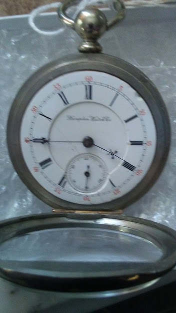

Kevin Hoffmandial

Jack MarshA nice one Kevin. I like the cool blue screws, and Fleur-de-lis hands.
A great early Hampden. Thanks for posting it. Jack

Rick HufnagelHi Kevin, sweet railway.
I had been watching that one, and I know your pumped about it and don't want to rain on your parade, but a few points from my observations.
The blue screws, the double sunk dial, and the nickel case. All do not match any observations I have.
Close to your watch I have in observations:
69055
69105
69164
69165
All have single sunk dials, all have either polished steel or Gold screws. A big clue on the screws, look at the jewel settings. The silveroid case has extra screw marks, meaning it once held another movement. The double sunk dials I don't see untill beyond 100,000. I have an early model 2 that someone stuck a double sunk dial on, but I think it looks great and left it on there.
Now with that being said, i think it's still a fantastic early Hampden Railway. I only responded the way I did because you seemed like you wanted to know about originality. I promise I'm not trying to be a jerk.

Kevin HoffmanThanks Rick , you could be right , after 100+ years it my be hard to say , I think I am ok , I have seen 69105 ,I think Ed Ueberall had a list showing 69052.69129,69137,69141 ,69164, 69166,69256,69220,69260, here is the weird 69158 is a SW/LS and so is 69776 and 790 , what the heck was Hampden doing !There is an advert from S F meyers that shows keywind hampden railway with D.S. dial . With Hampden nothing is set in stone .
It needs to come apart , but it will be a while , I am still helping mom and not by my tools .

I've seen the later listings with the Railway model 1s being advertised as having double sunk dials.. I just haven't seen where they would possibly fall yet. My thoughts are a later run. In the 1886 catalog I'm looking at from H Muhr and son, it is not listed as having a double sunk dial. Who knows. I'm sure there's a run of them hidden somewhere. Just need more observations.
