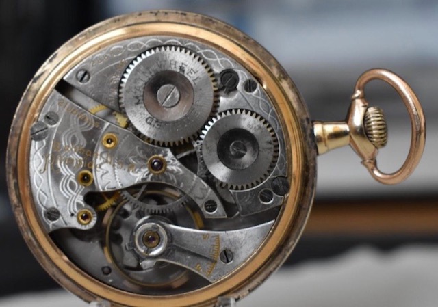

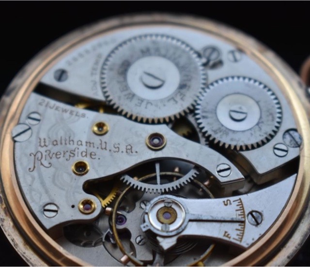

Kelly HaydenHere are two separate pics as the combined file was too big.

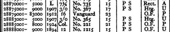

Waltham serial lists (the "Gray Book") designate the run 28,879,001-28,883,000 as Grade "Vanguard" with 23 Jewels. It was common for Waltham to combine similar consecutive runs within these serial lists. As a result, it is not unusual to find a movement within a run that does not precisely match the factory lists. When in doubt, trust the watch.
Your movement would certainly be classified as a 21-Jewel Riverside.

Chris AbellDo you have a clear photo of movment, it may reveal plates changed.

Nathan MooreHealthy skepticism is always beneficial. However, in this particular situation, even with the blurry images, there is enough evidence to identify the movement as an original 21-Jewel Riverside (No. 1621). There are various distinguishing differences between this Riverside movement and the 23-Jewel Vanguard of the same vintage.
1. The 23j Vanguard would feature Ohlson's 1908 regulator instead of a simple regulator
2. The 23j Vanguard would be marked “6 Positions” instead of “Adj. Temp.”
3. The 23j Vanguard would feature screw settings on the top center jewel.
4. The 23j Vanguard would feature capped pallet fork.
5. The 23j Vanguard would not be marked with “Jeweled Main Wheel” on the barrel.
6. The 23j Vanguard would feature raised gold settings (most evident when analyzing the top balance jewel).
With several other minor differentiations to provide additional support, we can be assured that this is not a Vanguard that has been a victim of plate swapping. The finish, markings, and other traits are entirely consistent with the 21-Jewel Riverside (No. 1621) that Waltham was producing at the time.
With that said, uploading clear images would be prudent for further evaluation, support, and documentation.

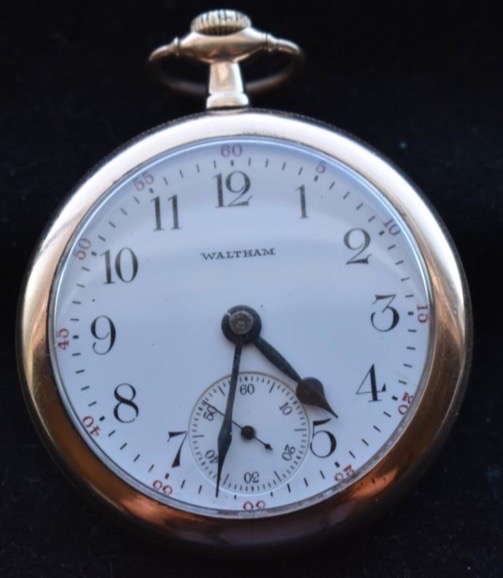

Kelly HaydenThank you all for your responses. I am new to this hobby and have a lot to learn. All of your inputs have allowed me to know that "I have a long way to go" when it comes to my knowledge. Thanks
Two pics to follow.

Chris Abellif you are skilled to remove the balance cock you may want to check the serial number stamped in bottom.
There are a good few other things that dont look right either.

Kelly HaydenThanks Chris, I will endeavor to do so and will post when I have completed it. Also another thing that is apparent is that it is not the original case. I'm sure that is not a revelation based on the age of the watch. The current case is a "lever" set case but the watch is pendant set. Thanks
