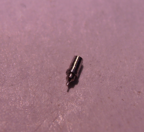

Sometimes a part just isn't available and the only choice left is to make it. This rare Rockford wind indicator had a broken pallet pivot. Unable to locate the part, it had to be made. Fortunately the arbor is pressed into the pallet and not screwed in like many are. Sometimes you can re-pivot. The first picture shows a hole drilled into the end of the existing arbor.
January 26, 2013, 18:37
Roger J. Nolfe
This picture shows the drilled arbor next to the pallet.
January 26, 2013, 18:41
Roger J. Nolfe
There really wasn't enough shoulder left to fit a new pivot comfortably and the work involved would have been as much as making a new arbor. Using the old arbor for a model, the new part begins. Pivot diameter is .11mm or approx. .004" same as a typical balance staff. It was intentionally left long.
January 26, 2013, 18:48
Roger J. Nolfe
Progress is made turning the shoulder.
January 26, 2013, 18:52
Roger J. Nolfe
Finally part is complete except for final fit. The part is polished to a mirror finish but the picture doesn't show that well.
January 26, 2013, 18:57
Roger J. Nolfe
There is more involved here, including selecting the right material and gravers to do the job right. There are cap jewels on the pallet so end shake was especially critical. I was able to turn the pivots to make a perfect fit in the hole jewels. In the end, a part indistinguishable from a factory original was made and installed making a rare watch live again.

I didn't keep track of the hours involved and it took awhile to come up with the right combination of material and gravers to use. I also had several failures along the way. If I had to guess I probably spent 4.0 hours or so at this BUT I learned a lot along the way. An old time watchmaker could probably have made the part in less than an hour...without the advantage of great lighting and a microscope to work under. I have a great appreciation of the abilities of our predecessors.

Bruce...I tried several materials including pivot wire, but ultimately settled on drill rod. I purchased a good supply of very small broken drills, the rod diameter is just under 1mm and the tips of the drills tapered to sizes of around .25mm.
Bruce S....If your gravers are sharp enough, you should be able to make the modification without any heat treating. You might spend as much time re-sharpening as you do working, but it is very important. I also like carbide gravers.

Roger's tenacity and talent in fabricating the part was very much appreciated, since finding a replacement was nearly impossible. Not only did Roger mill a replacement for the busted pallet staff, he re-set the pallet stones, re-poised the wheel, and re-shellacked the roller jewel to correct multiple problems - and it's keeping perfect time.
