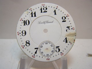

This is the original Dial. It's in pretty bad shape. The bold dial that is on the watch in the photo has a lot of hairlines also.

Despite the damage that "South-Bend" script-signature dial is likely correct for your pre-1910 movement, the block-lettered dial with bold numerals is from somewhat later, I would recommend saving it for another watch.
