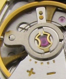

Pre-WWII pocket watches have round balance jewels, but most post-WWII mechanical watches seem to have "figure eight" balance wheel jewels (as shown below on Juvenia). I assume the balance jewel is shaped like a figure eight because of an "incabloc" thing, but I would be grateful for an explanation.
June 11, 2011, 23:24
Tom Bruntonhi Ethan; I think perceptions can be deceiving!!! The jewels are round,but end cap jewels have the hour glass which is a thin spring device and attached at one end over them, giving the jewels (and the balance staff) a bit of cushion under shock and I that's how the Incabloc works. The illustration is of two point contact and three point contact systems which I think more clearly shows that the jewels are round but held in place under tension by the incabloc or other system
