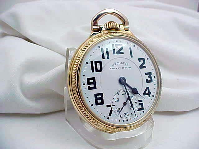

Is this a correct combination? Movement #S15834
September 14, 2006, 00:14
David,
Most collectors would tend to give a simple "no" as their one word answer.
At that S15834 which according to the John F. Gelson Listings is 1951 production most collectors would expect the Hamilton 23-Jewels Railway Special Dial and baton hands which are normally associated with 950B movements of that time-frame. Some would argue that other dials were available and that may well be true. (In fact a Melamine Heavy Gothic Dial is illustrated in the 1953 catalog in such a way as to be confusing in that regard. It is shown with the same style hands as shown on your example and whether or not it was available on a 950B in 1951 could be argued.) However, the dial shown in your image is normally associated with a 1940s 992B in the minds of most collectors.

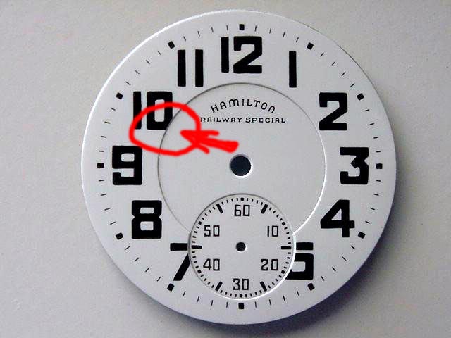

To explain it further, that particular dial shown in your image with an unusual "clipped" lower right corner on the 10 hour number is a unique porcelain-enamel variant that shows up regularly on immediate postwar 992B movements. More than likely that where this one originated and for that reason along with the fact that by 1951 melamine dials were in regular use I would have serious reservations about that particular porcelain-enamel dial being correct as shown on the example.
Now to that case, the Rolled-Gold-Plate Hamilton Model 16 Case such as shown in your image began to show up around 1953 which is somewhat later than the movement and additionally a Model 16 case is usually associated only with 992B movements. That is how it is presented in Hamilton catalogs all through the years and to the end of 992B production. I have yet to see a Model 16 case advertised with a 950B and in the absence of documentation to the contrary would tend to doubt it would have normally been available that way from the Hamilton factory. The 950B is associated with Gold-Filled and Solid Gold cases but not with Rolled-Gold-Plate or for that matter Stainless Steel cases.
We've learned to "never say never" but the combination as shown is unlikely.

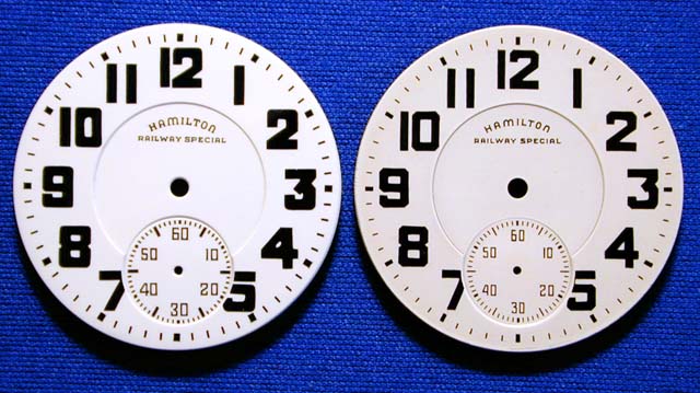

Please carefully re-read my previous post and check the two images below. I think you'll then agree with me that what is shown in David's image at the beginning of this topic is probably not an original combination.
To begin with, the dial shown in the image David provided is uniquely 1940s porcelain-enamel. The fact it is not melamine can be determined by the squared off numerals. Melamine Heavy Gothic dials have 45º corners on numerals as shown on the right in the comparison below this posting. I believe your reference to 1954 is the 950B being available with choice of two dials, a porcelain 1940s dial is probably not one of them.
Add to that the movement in question is from 1951, which may be prior to 992B in Case 16 introduction. The combination shown above is unlike those listed in contemporary catalogs. Perhaps you could help narrow down the date when the Case 16 was officially introduced but I find it in the 1953 catalog and have not seen it illustrated prior to that time. Your very generous help in research is always greatly appreciated.

Melamine dial on the right with 45º corner numerals...

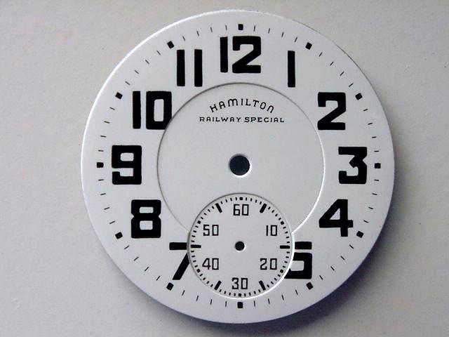

September 16, 2006, 06:17
Not to labor the issue, but to provide additional information this dial shown in the image below with sharp corners on the numerals and "clipped" lower right corner on the 10 is a porcelain-enamel dial we often find on 992B examples from the immediate postwar period. In other words it is from 1940s production and this particular dial is an unusual variant unique to that time period. An identical porcelain-enamel dial with squared numerals and "clipped" 10 is clearly shown in David's image at the beginning of this topic.
"Clipped" corner 10 is a 1940s porcelain-enamel dial...

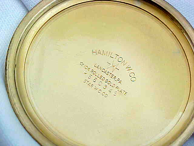

Turns out David Johnson is away for the weekend. I could not reach him by phone to get the Case 16 Serial Number, my eMail from this morning tracked him down and he was able to send the image you see below which is of the inside of the case-back we needed for additional research. The case serial number shown in the image below with "P" prefix on the number P560345 would indicate it is evidently a considerably later case than the 1951 movement it is shown with. More information later.
Case P560345 from the watch David asked us about...

Fully documented as early Case 16 examples in fact have an "R" prefix serial number. Yes, strange as it may seem the Star Watch Case Company actually used "R" prefix before they used "P" in their numbering system. As an example I have a 992B C419726 from 1954 in Model 16 Case R508733 with boxes, label and papers. Three others are documented by original box label images provided in the "HAMILTON 992B SERIAL NUMBERS" topic of our "Hamilton 992B Research Forum" and they help confirm what we are coming up with here.
992B C396951 (1953) in Model 16 Case R337916
992B C408625 (1954) in Model 16 Case R335583
992B C419726 (1954) in Model 16 Case R508733
992B C458650 (1959) in Model 16 Case R795953 (Projected Year)
Since those listed above are all documented "R" prefix examples it would appear that Case Model 16 examples with a "P" prefix serial number may not have come into play until the latter part of the 1950s or later. Summing up the information we have developed, it appears the watch David asked about is a 1951 movement with a dial from several years earlier, remember the dial shown turned out to be a 1940s porcelain example. We also have established from Robert's patent information along with the serial number indicated on it the case turns out to be be from something like a decade later than the movement.
That case number being P560345 and Robert's patent information pretty much seals it, looks like the watch David is being offered cannot be an original 1951 combination. Unless that one is bargain-priced it may not be a worthwhile purchase. Many of us would tend to view it as components and nothing more. Finding a choice case, dial and hands for that movement could prove not only difficult but fairly expensive.

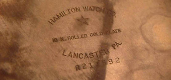

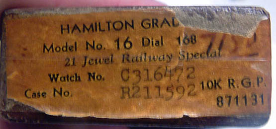

For what its worth, I have a 992B boxed set with an earlier Case #16, C316472 (1951) and R211592.
This early Case 16 is different in markings from the much later one on the watch David posted.
Here are a couple of photos:
Box Label
September 16, 2006, 18:48
Edward L. Parsons, Jr.
Back cover -- note the "star" logo.

Ed's early Case 16 numbered R211592 with 992B movement numbered C316472 is the earliest I've seen at this point. Has anyone seen a lower numbered Case 16 combination? Most interesting to me is the $71.50 price point which is exactly like the advertisement Robert found. Turns out Ed has been collecting and researching what could be called the "plain brown wrapper" version of 992B watches. By that I mean they were packed in a plain outer box, brown rather than blue and no plastic inner box was included with them. Apparently the Case 16 introduction was intended to allow Hamilton to offer a bargain-priced 992B and the lower price of a Rolled-Gold-Plate case apparently allowed them to do just that. It will be interesting to see if other cases were made available at that low price as well.
Put that together with the use of "Nine Adjustments" in the ad Robert provided and we see how Hamilton was going to-to-toe with Elgin in order to grab whatever they could of the rapidly fading Railroad Watch market in that early 1950s Korean War Era time frame. On this very subject and perhaps of further interest is the Elgin advertisement facing the Hamilton one on the next Page 24 of that same magazine. In that ad we see Elgin pushing the fact they have produced more watches than any other maker and promoting their B. W. Raymond 571 being available at... you guessed it, the very same $71.50 price as the Hamilton offering.
Perhaps Ed or other members can add more to this and show us a nice "plain brown wrapper" combination of a Hamilton 992B at the low $71.50 price point. Documented examples add so very much more to our knowledge and increase our depth of understanding.

To explain a bit further, some of the 992B examples from the immediate postwar period have this unusual "Clipped 10" trait. These particular dials in fact represent a rather unusual variant with the lower corner of the 10 being "clipped" or cut off which is unique to that time period.
Some collectors believe the cause of this odd situation may relate to porcelain dial production problems or perhaps just a lack of attention to detail. For whatever reason they happened, happen they did and it was during the immediate postwar 1946-47 time-frame.
"Clipped" lower right on the 10 used to date the dial...
