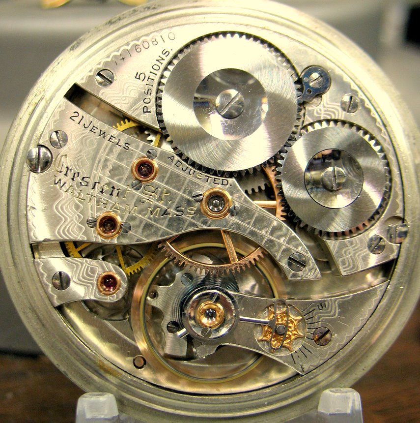

So my point; After TRULY seeing a watch accurate enough so that I could experiment with how to make it "hold time" within a few seconds a month, I think I understand one narrow area of how to maintain pocket watch accuracy.

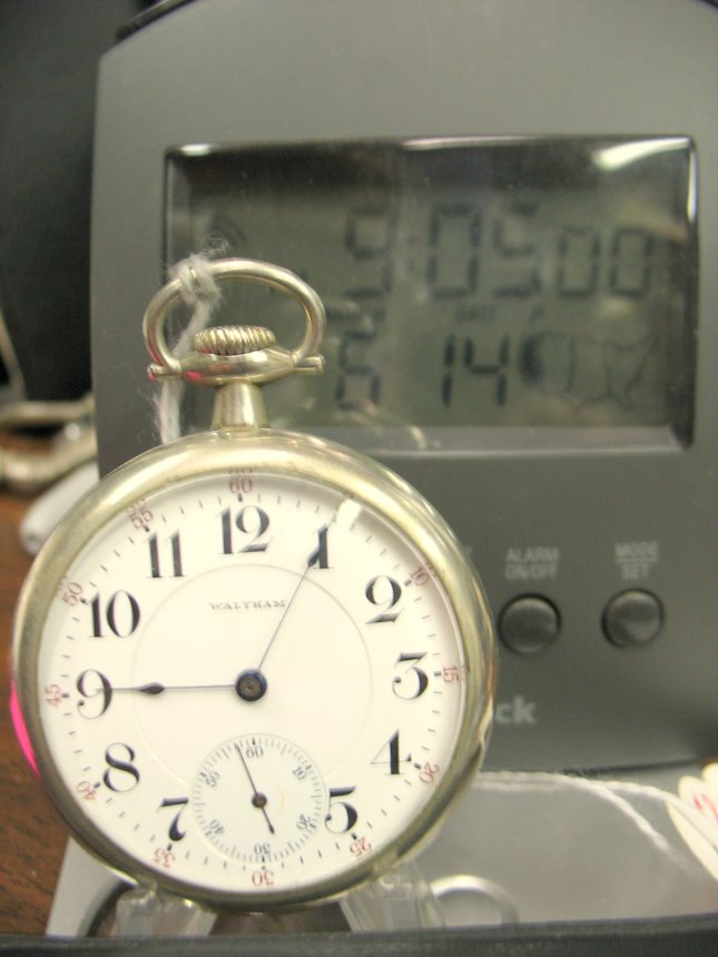

Since cleaning, re-staffing and regulating a 16s 21J mdl 99 Waltham Crescent St on April 1 (no kidding) I have been observing its behavior to winding cycles, once and twice a day. If I wind it every 12 hours, it will lose about 1/2 sec a day, and if I wind it every 24 hours, it gains a 1/2 sec/day. So every week I cycle the winding back and forth, and it keeps within 5 sec of actual time.
The effect will change over time, but the causes are only the "isochronism errors" caused by variations of mainspring tension on the train and escapement. When the tension is lower, there is a slightly lower "kick" and a slightly faster cycle.
It is really nice to have a movement so accurate that you can actually see the results of this type of isochronism. I am certain this is why Hamilton warned their dealers that each watch has to be calibrated to the (habits of the) user.

You can see that through the course of this little experiment since 4/1/2010, this "worn old Waltham watch has kept within 5 sec accurate for over 10 weeks.

David AbbeThis is the best 21J version because the motor barrel is Jeweled. Waltham added a pair of cap jewels to the escape wheel to make it 21. I used the micro-regulator for the last error correction when I timed it.
