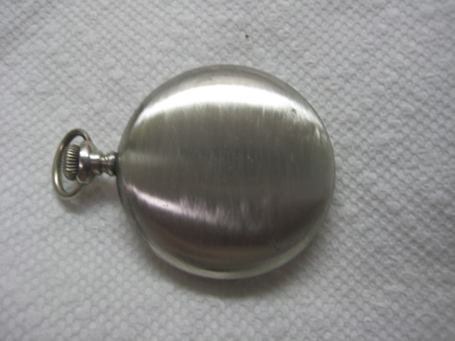

I recently purchased this watch Waltham from Eugene Buffard because of it's dismal (sorry Gene Smile) appearance. But when I saw it for sale I knew it was exactly what I was looking for. You see, my interest was in the appearance of the case itself as I was wanting to try my hand at surface restoration.
This case fit the bill perfectly as it was cheaply priced, and did not appear to have any dings or other damage except for the surface degradation. The front screw down cover appeared rusty and pitted, and the back cover looked just as bad, but had what I thought was a dried sticker type substance on it. I also knew that this would be a perfect candidate since it still had the old plastic crystal that had since turned Green, leading me to believe that the watch had gone untouched for some time.
When I received the watch in the mail a few days later I was happily surprised to find the case in worse shape than I had originally thought it would be. The rear lid did not have a dried substance on it but instead appeared so deeply pitted that it looked like someone had tried their hand at hand engraving.
After giving the case an initial deep cleaning, I began the surface prep with 400 grit wet/dry sandpaper, slowly sanding away the rust and pitting and eventually arriving at this point
case back 1

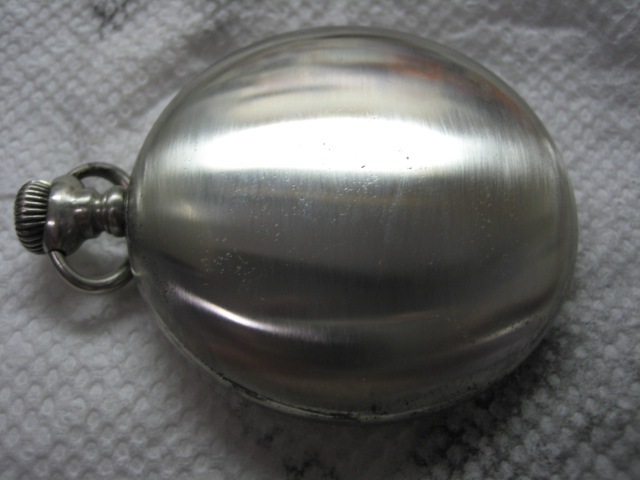

After sanding through the crud with the 400 grit I began using a 600 grit paper in the same back and forth direction, and in no time at all I was here

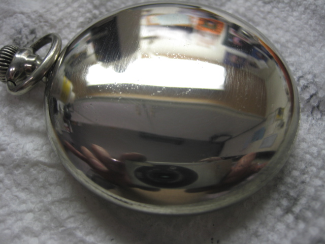

Pleased with the results thus far, I broke out a soft cloth and began hand polishing it using a semi abrasive aluminum polish and quickly had most of the sanding marks polished out.
May 25, 2012, 05:33
Ray Hallenbeck

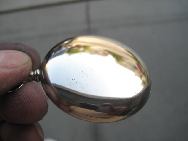

Next, I broke out a liquid polish called "Wicked Products Lightning Shine Metal Polish. It's a non abrasive polish like Semi-Chrome or Flitz and was able to obtain this high gloss mirror like shine within seconds.
May 25, 2012, 05:49
Ray Hallenbeck
The case still has a few very light pits in it but overall, I am very pleased with the results thus far. I plan to give it another quick sanding and polishing tomorrow and I am hopeful that I will come out with what will look like a new case. I will post pictures once completed.
