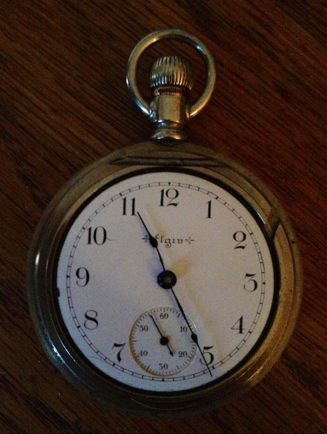

I have 2 watches.
1. An elgin watch which is obviously a swing out but not a lever set. I took the front ring off and the stem pushes in and out. It swings out part way but not all the way. The top part of the stem unscrews and exposes circular, threaded stem underneath. Don't want to break it any suggestions.

For Mr. Cook
Swing case with bezel
April 26, 2013, 01:07
Paul D. Trombley
Elgin, bezel off
