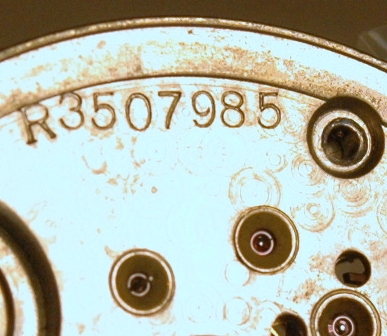

May 01, 2023, 18:42
Bila WirriganwaltersThanks Larry for the response, below you will see another marked with the "R", it is only marked on the dial plate. THis belongs to a good friend, he is on another Forum and has given me permission to post his photos
Both he and I are as curious as you are to why the "R" before the serial number???

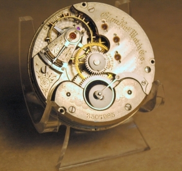

May 01, 2023, 18:43
Bila WirriganwaltersHere is the back-plate view.

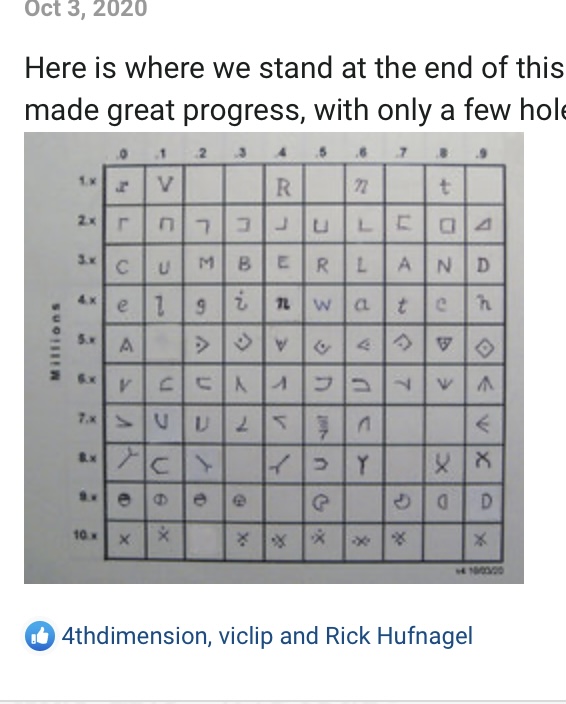

Larry HelmsBila,
looks like elgin used letters for the first numbers over one million. For instance the R is seen in row 3x and column .5. This would indicate 35. This is seen under the balance cock on mine R07256.
May 02, 2023, 10:59
Steven FordLarry,
Here's another that fits your grid.
I've seen others with letters and symbols at the start of the number, but I don't have photos of them.
Steve
