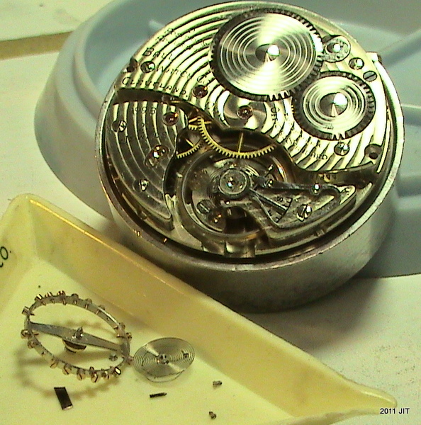

In comes a 16s Ball/Hamilton 999B to clean up. First Inspection;
Hairspring stud lock screw missing from Balance Cock, NP
The second Hand fell apart, NP
There was 0.007" (0.2 mm) thick piece of Mainspring shoved under the back end of the Balance Cock!
I dis-assemble and clean the watch, clean, polish and inspect the Jewels, test fit the Balance wheel for a spin test without the shim. it flops around like the top staff is broken.
I look more carefully at the details of the Balance wheel and staff;
1. Home-made Hairspring Collet. Looks like it was finished with a #10 Horse-shoe file.
2.
METAL Roller Jewel Hand-Filed so it "works"
3. Balance wheel Crossbar
DRILLED OUT AND FITTED WITH A RIVET TYPE STAFF! WHICH BENT THE WHEEL AND CROSS BAR SO THEY HAVE BEEN RE-BRNT TO A "LAZY S" CURVE SO THE RIM "RUNS STRAIGHT".
Using a New 992B staff, I validate that;
A. The jewels and plate mechanics are OK, the staff fits fine without a 0.007" shim.
B. ALL the hardware for the Balance wheel assembly have been filed or drilled out to fit the too short Brand X Rivet type staff.
This Ball Hamiolton 999B Balance wheel parts set has been ruined in the Crypt by the
WATCH MONSTER!
Anybody have a new or used but serviceable 992B wheel assembly? Broken staff is OK.

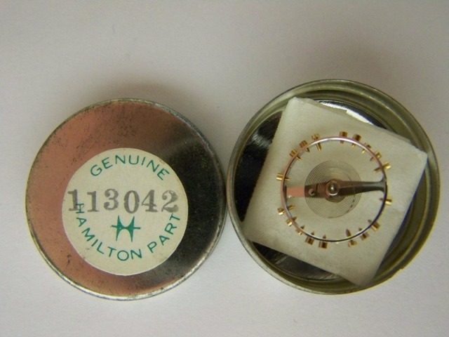

Jared BrinkerDavid-
I have some NOS complete 992B wheels. It might be a little more than you're needing, but would make for an easy fix for you. The factory number is in the picture. I'm not too sure what a fair price would be on them though.
Jared

David AbbeWith the Help of the late Douglas Addy via Jared, a Ball Hamilton is SAVED! Note the debris field in the foreground.
October 26, 2011, 20:56
Jared BrinkerDavid-
Beautiful watch and now running like it should. I'm just glad to see the parts go to fixing good watches instead of sitting there unused. did you even have to do anything with it or were you able to basically drop it in? since I have a couple more it'd be useful for future projects.
Jared
October 26, 2011, 23:43
David AbbeJared, I had to do two things, adjust for a slightly (about 0.05 mm) longer Staff, and Adjust for timing ever so slightly.
With the new wheel installed Beat was 0.5 m sec, and it "Turned on" at 18006 BPM, so I brought it "down" to 18002.
An excellent save" considering the beating this watch took.
