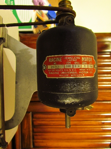

I did not realize how small these jewelers lathes were. The flat part of the slide is 32mm. The channel is 8mm wide. It is made by Racine or at least the motor is.

Motor

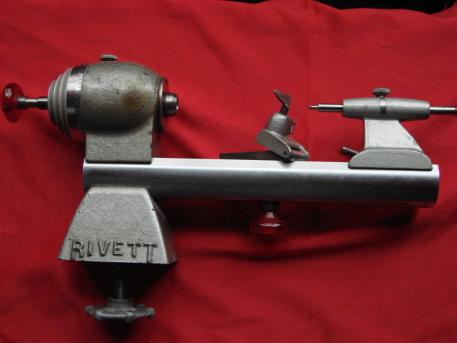

my R1 Rivett

That sure is a nice looking Rivett you have there. I like the way the head unit is built. I need to get a tool rest. There is an old one on Ebay right now I will see if I can get.
