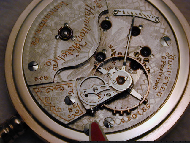

The whole point of having a micro-metric regulator is to have a combination of fine adjustment and the holding of spring tension against it so it will not move if subjected to a sudden jolt or slam. For that reason, they were a basic requirement on RR watches.
Hamilton 18-size RR grade watches have the style of regulator you see below in this picture. See the head of the adjustment screw at the end of the red arrow in the foreground? It will be pretty obvious to you how they work by simply examining this photograph. You'll see there is a scale for the reading the setting way over on the other side.
The reason you haven't "gotten it" before is because the movement is almost invariably photographed from the opposite side. There the lettering faces you, but you would not see the screw and therefore be unable to comprehend the design.
Ball-Hamiltons used a far more conventional design in accordance with Webb C. Ball's strong belief in simplicity.
Hope this helps!

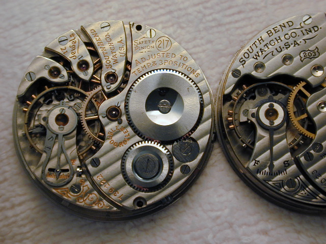

On these two movements below you can readily see how simple and effective a micro-metric regulator can be. The 17-jewel South-Bend on the left has one, whereas the 7-jewel on the right does not. Unlike the Hamilton above this South-Bend design kept parts and thereby complications to a minimum.

February 26, 2003, 07:22
Wayne C. Anderson
Lindell,
I was wondering what the 217 and 203 marked on the two movements indicate? Could it be model numbers? or grade? Great picture of the Hamilton regulator. Thanks
