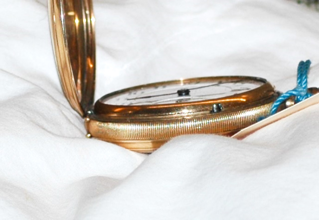

OK Kevin: Here is my attempt tp post pictures.
The watch measures right at 10mm thick. I don't have a fancy digital measuring device so I may be off some. The lever fits right where it should on this watch. but the half the thickness of the dial is all I need to gain to get a proper fit.
Picture from the side:

Charles, it could be that you just need a higher dome crystal.

Lorne, I tried a slightly higher crystal thinking the same thing, didn't survive one closing, didn't have anything in between. Other thing is the bezel doesn't snap down like I think it should. It isn't far from fitting but not perfect. This is an example of why a certain ebay seller shouldn't be dismantling watches and selling parts. Although it is possible this was never used because it didn't fit anything and is in near mint condition.

Charles,
We need to step back a bit and most of all avoid any further damage.
From what little I can see in your pictures, there are obvious signs of wear on the case so it is not previously unused.
Also, in the late 1800s and early in the 20th Century, movements, particularly hunter movements were specially "fit" to the individual case chosen by the original owner, often this involved substantial modification and of course the lever access cut at the proper position was also part of that process. This is also the time-frame when standardization in movement size was coming into play.
If you want to know what movement will properly line up in this particular case begin with the case-screw marks as a first step in determining what was in the case prior to your acquisition. Hopefully you have not added any more marks and if only one movement was in this case before, perhaps that would be a good starting point. You might simply ask the previous owner what movement they removed! However changing movements around case-to-case is not a wise thing to do.
But when determining whether or not this movement or that will work in a case, set the trial movement into the case with the dust ring in place on the movement. Do not begin installing screws, let alone the bezel until everything else lines up properly, sight it from the side and back. Work very slowly and methodically, hunter case crystals are in short supply as are hunter cases. Be very, very careful you could also damage the dial or for that matter the movement.
If this is beyond your expertise then get qualified hands-on assistance.
ALWAYS REMEMBER: "First, and foremost, do no harm"
