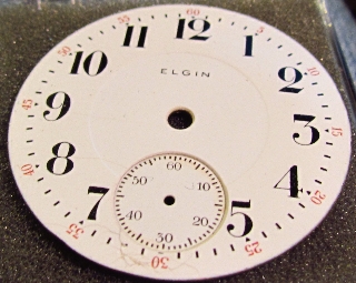

Pete I will have take a picture and show you the dial.

Here you go Pete. Size 18. Hairlines at the bottom of the dial maybe would clean up. Looks better in person than in picture. Feet at about 54, 16.5, 36.5.

Elgin 18s

You know John after looking at my dial and yours
and few on ebay I like the big black # best.
Go figure.So hunting continue .

I'm with you Peter.
