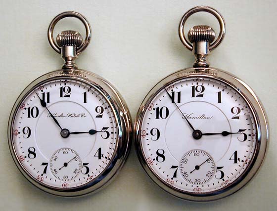

Eric,
There were a few choices and variations in Hamilton hands around the turn-of-the-century, specifically 1902 when your 940 number 180697 was produced. Hands were not as bold then as they would become in later years. The hands and for that matter the dials you see below on 140158 on the left from 1901 and 483621 on the right from 1906 are fairly typical of that era.
Below, representative correct for around 1902 Hamilton hands...
