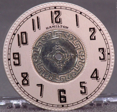

October 06, 2011, 14:28
Harry J. Hyaduck Sr.Hello David,
Please let me know if you need anymore photos. I will attempt it again if you need me too.
Let me start off by saying I think you are right about the conversion. The dials feet are at 7, 23, and 43 which enables the 12 on the dial to line up with the 3 position on the hunter movement.
As you can see in the photo it says Hamilton.

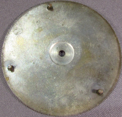

October 06, 2011, 14:29
Harry J. Hyaduck Sr.Back of the 975 dial.

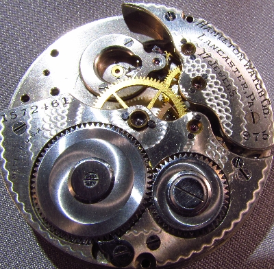

Harry J. Hyaduck Sr.975 movement.

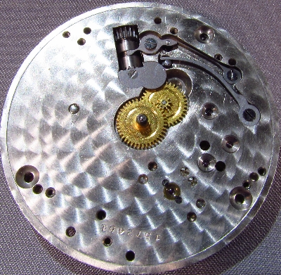

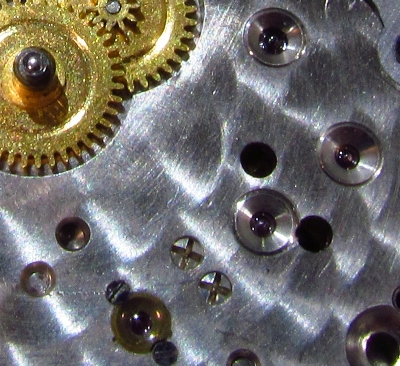

October 06, 2011, 14:35
Harry J. Hyaduck Sr.Close up of area.
October 06, 2011, 14:36
Harry J. Hyaduck Sr.Movement side.

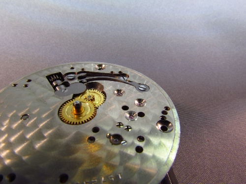

October 06, 2011, 15:00
Harry J. Hyaduck Sr.Another view.
October 06, 2011, 15:05
Harry J. Hyaduck Sr.Last one

David AbbeGood pictures, that helps a lot. The s/n1572461 is a 1923-1924 Vintage 975P movement. Closer inspection of the dial plate second staff area shows only that the seconds staff is certainly not there.
The dial itself could be restored by International Dial.
I would look for a sterling 3-hinge case to hold it.
The broken staff is no problem, and I suggest that this had some fancy hands and was in fact specially fitted for someone who wanted that classy engraved dial without the seconds chapter to muck up the art.
The Hands would be fancy, open diamond or Louis XIV. I would gravitate to the Open Diamond.
