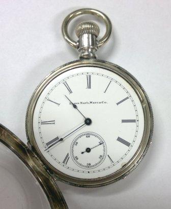

I have attached a photo to this message and will post a second. Photo shows the case with the the Elgin movement that fits snugly. The case is definitely around size 16 as the other Elgin size 16s movements I have are only just loose in the case. Photo of the front without the bezel show the factory cut slot for a lever at 12 minutes on the dial. I'll have a look and see if I have a 16s Hampden to try.
Thanks
Geoff
Front Without Bezel

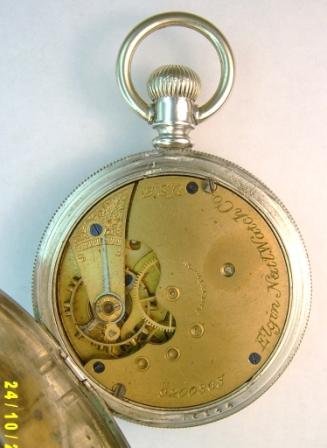

October 29, 2012, 22:36
Geoff Osborne
Rear of case with movement fitted.
Rear View
October 29, 2012, 23:28
Buster Beck
Well it appears to be a 16sz, Model 5, Grade 182 in Pendant-Set, circa 1901,
So I don't know what the case originally held as I do see that another movement has been in the case.
The lever slot cut at 12-13 minutes is a mystery to me but I know its not cut for a Hampden/South Bend/or Illinois Getty movement as they require a lever slot at 8 minutes.
