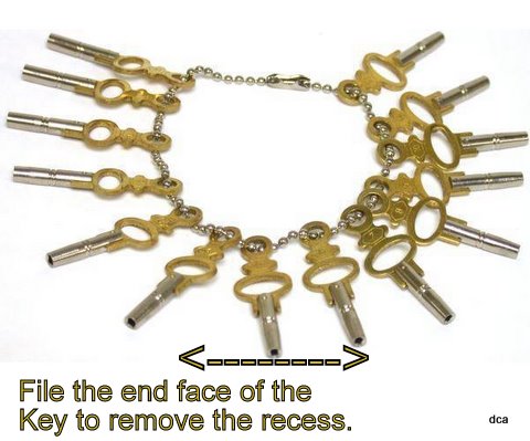

thanks all Dave explain what do I need to file
on those keys just rough edges? or more to it.
September 21, 2011, 12:34
I did a "how to" on the pic, I hope you ujhnderstand. There is a round recessed countresink at the key hole end that needs to be removed so the short "nose" coming out of the minute hand from penetrating into the square
September 21, 2011, 13:41
Peter Kaszubski
got it thanks Dave .

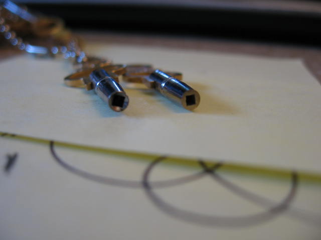

Jerry King
I guess a picture IS worth a thousand words....
Here is a picture of before and after....Both keys are #6 keys....
Key on left is "Before" / Key on right is "After"....
I don't use a file, I use a whet stone....
Thanks Dave....
