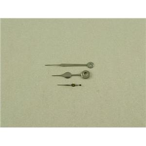

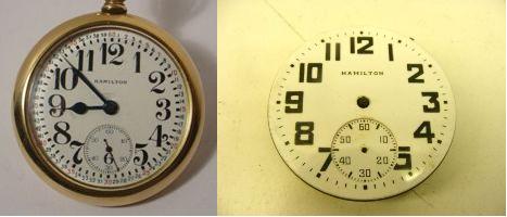

Secondly it is currently sans face and hands, now as I understand from my readings any of the then available hand / dial combinations were available for it Barry Hanstein has both Black and Blue hand sets available on his site but I am wondering what dial I should aim for would this be legitimate
September 12, 2011, 14:39
Gareth EvansCombined with this hand set. As usual I am here to learn and be corrected.

Mike HodgeGareth, That is a nice dial. Most 974's have single sunk dials, but there is nothing, in my opinion, wrong with a DS. That will look great in a display case just ticking away. Show us the finished product!
Mike

Gareth EvansUnfortunateley the only SS dials I have found so far are labelled as "Railway Specials". I guess that the purists would suggest ideally an SS HA "Electric-Interurban Special" Montgomery, or plain SS HA would be technically be more appropriate. This dial/hands configuration is on a 1932 movement which I quite like and notice it is a DS

The hands you will want to use are blue as the charcoal gray was not used until the 992B era, prior to that all Hamilton hands were blue. Barry is a good choice for the hands and you might ask if he would have a suitable whip-spring as well. Often the retaining screw that holds the whip in place is also missing and if you need that it is something to be sure is included.
By the way, my theory on why so many "whip-springs" are missing from movements has to do with the fact a watch that is in need of oil will tend to run very fast, one that is dirty, very slow and to make such a watch run within practical limits people would remove the whip-spring and move the regulator to an extreme setting that could not be accomplished with the whip-spring properly in place.

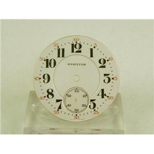

Gareth EvansSo just to clarify the Dial signature should be the middle one the Script being to early and the rounded Capitals too modern
September 16, 2011, 09:06
Gareth EvansSomthing like either of these...

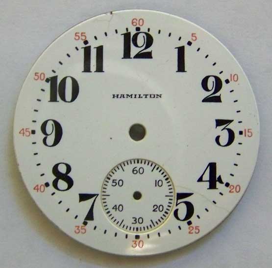

Jared BrinkerGareth-
I pulled this dial off of a 974 special, so you should be looking for one of these. Looks to be the same as your double sunk above, only single sunk.
Jared

Gareth EvansThanks for the confirmation Jared I'll start to look for one, unfortunateley all those I have seen so far have been the older script style 'Hamilton', but I will persevere.
