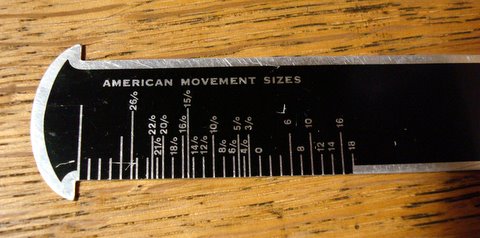

Hi Ruben
I do not know of an on-line site for those two brands. If you have "Complete Price Guide to Watches" on page 34 is a scale to determine the size of a watch, also you can buy a gauge that can be used.
Feel free to ask, we like to see photos of watches and questions about them.
Gauge
