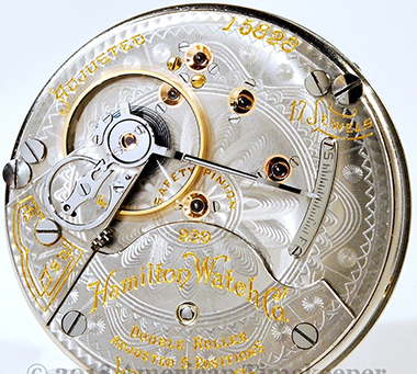

Harry J. Hyaduck Sr.The story has a happy ending!
After being run over by the USPS and crushing my 939 and doing a lot of damage I finally have it fixed.
It got run over being shipped to my watchmaker to just have it serviced. My watchmaker told me he did not have the equipment to make the jewels. This particular Hamilton is different than all the other Hamilton's except the 938 both of which are low production movements. So I contacted Quinton in N.C. who used to make jewels. He sold his equipment and can no longer make jewel settings.
So strike two. I contacted a member here about repairing my watch and he said he could not do it. So I contacted another person. He ended up making two jewel settings and setting two new jewels in it and ended up using my gold setting and putting a new jewel into my old setting not to mention all the other things he did to get the watch running.
So after 3 strikes I hit a home run.

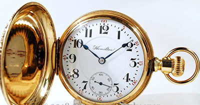

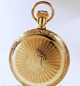

Here is the pictures he took of my watch after he finished.
Harry

Roger StephensGreat news Harry,fantastic save!! Looks great.

Gary E. CochranHarry turned out great...A real beauty...

Timothy FitzgeraldI am so happy with your outcome. I's a great watch

Joseph BlossicHarry, that is an amazing story and an unexpected but fortuitous outcome. It looks great! Can you share with us who that watchmaker is? It be good to know if I ever need that kind of work to be done.
September 20, 2018, 08:01
Rob CarterIt running and telling time again Harry just as it should. Congrats Harry!!!
