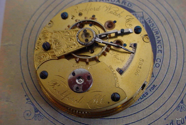

Kevin HoffmanHere we go again !, I believe the early records have a few errors ,  I have a rockford that is stem wind and lever set S/W -L/S with a serial 53195 , there are few more in this block that appear to be the first stem wind rockfords , my numbers match , and has a square pinion , from what I can tell it is original , and i have come to believe a model 2  , interesting thing -look where 21 jewels was inscribed under regulator, wonder who did that ?

Kevin HoffmanHarry , there is something odd about the lever ,it is small , and seems to be in a different place than other Rockfords but it has been too long for me too remember , this one sat around waiting for a case , I tried to sell it , but nobody wanted a private label serviced rockford  for under 50 bucks ! I stuck it in a openface that had 2 crystals and will keep it until a silver hunter comes by . harry could you post some pictures , what is blocking a regular case from working
 Lindell made a comment about Rockfords and the abbott conversion here    -
https://ihc185.infopop.cc/eve/f...376054962#8376054962.

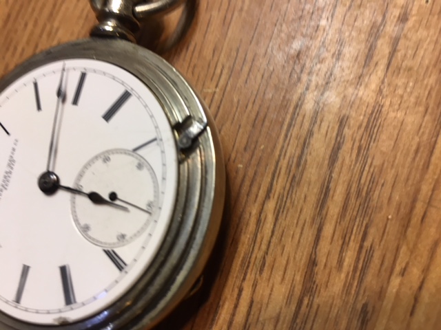

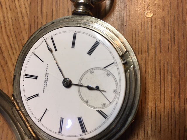

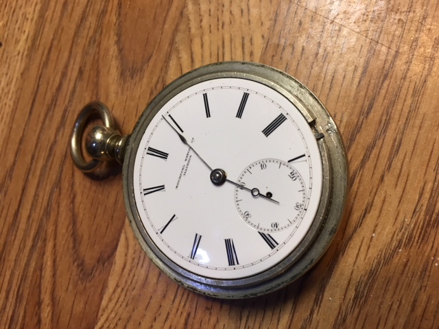

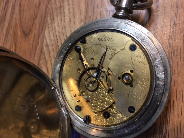

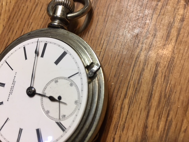

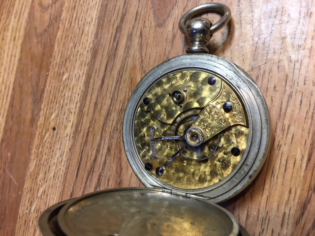

Harry J. Hyaduck Sr.Hi Kevin,
Here are pictures of 36880 and I will post a reply separately for 7280.
This one is put in a regular three hing case which works well if I don't mind a sidewinder and do not mind using the stem wind. If I wanted to use the key wind (which does wind better) I have to open up the two rear lids to access the key wind or O would need to drill a hole on the curvet.

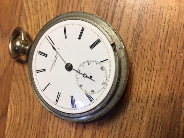

Harry J. Hyaduck Sr.Here is 7280. The lever does not have a joint in it like the lever on 36880. This on just pivots back and forth. This one is also gold flashed for some reason. I am going to have to put this in a regular triple hing case so I can wind it and set it. I can h=open the back to wind it but I can not set it without a winding stem as the square does not set up past the minute hand.

Kevin HoffmanThe 36880 I believe is a model 2 , it has 2 mounting screws -model 1 has 1 , there is a 33290 in P/W database photos that is listed as transition . Have you had yours apart ?  I also saw an earlier one listed  as transition . My set lever is like the 7280 , it just seemed odd,and small , and required a little filing to the case
October 26, 2017, 20:32
Harry J. Hyaduck Sr.Kevin The Price Guide and The Pocket Watch Data base both say it is a model 1. As you well know there are almost as many mistakes in both of them than there is correct information. The 36880 stem wind mechanism is very crude and sloppy. The two case screws made it a lot easier to mount into a case. I am still trying to fit 7280 into a case. The problem is trying to get the pin into the hole and the movement past the winding stem at the same time. I have a coin case that has a screw to remove the winding stem so I will probably have to use that case.
Here is part of an article I found on the internet that supports your Model 2;
  18 Size Model Descriptions
Model 1 – This model is described as full plate and drive train gears are not exposed. It has a rounded main
spring plate with styled rounded inner (nearest center) edge and covers approximately 25% of the watch
movement area. The balance cock is at the 8:00 position and the balance wheel is centrally located within the
watch area. This model stands out from all other models of this size by having only one case screw.
It is designed for hunter cases and is key wind and set. Set lever or crown winding action should not be present.
Model 2 – This model has the same appearance as Model 1 but it is key and stem wind, lever set and has two case
screws. It is often referred to as ‘the transitional model’ since it incorporated a change from key to stem wind.
Check for the presence of a lever on the dial side of the movement at or near the 2:00 position. It is designed for
hunter cases.
I believe you are correct and the Price Guide and Pocket Watch Data base are incorrect. I believe 7280 is an Abbott conversion and Abbott did a much better than 36880 Model 2 from Rockford.

Harv HolcombI just pulled out my copy of American Pocket Watches by Ehrhardt & Meggers. It shows 4 18 sz. key wind models, Model 1 is key wind and key set. Models 2,5 and 6 are key wind and lever set. All four show 2 case screws.
 Harv
October 28, 2017, 13:18
Harry J. Hyaduck Sr.Thanks Harv. That makes my 7280 a real puzzler. Mine only has 1 place for a case mounting screw. It also has a pin for the hole in the case. Mine is also gold flashed. So I don't know what to make of it. Maybe a prototype or special order I just don't know.

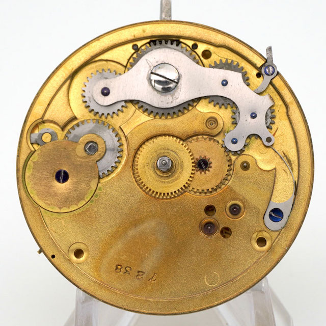

Nathan MooreHarry - I recognize your original thread is a couple years old, but I recently acquired Rockford #7238, close in proximity to your #7280. My movement also features the "rocking" lever to engage the setting mechanism.
After inspecting under the dial, I concluded the design is not consistent with the familiar Abbott conversion kits.
Despite patent searches not yielding any results, I believe this was the first transitional design to be implemented at the Rockford factory, fitted as an enhancement to the standard Model 1.
I also have #10303 in my collection, verified with the same mechanism.

Harry J. Hyaduck Sr.Hi Nathan,
Yes I see that on yours. Just like on the one I had #7280. I di read somewhere later that Rockford had made a mistake in starting their production at about the end of the KWKS era and entered the market when everyone was switching over to stem wide lever set or stem wind pivot set movements. According to the article Rockford rushed to changeover their existing unsold KWKS movements to the transitional style as their KWKS movements were not selling too well. Our two watches may have been part of that early period in Rockfords history where Rockford was trying to make the transitional movements and found that the small toggle type lever was not very good or practical. The much later Rockford I had with the hinged lever could have been an attempt by Rockford to lengthen the lever by adding a little more metal to the lever (I am only speculating). It did not work very well or at least mine did not. Just about the same time period I see Waltham and Elgin were experimenting with levers also. Eventually all three settled on what we normally think of as a level set movement.
