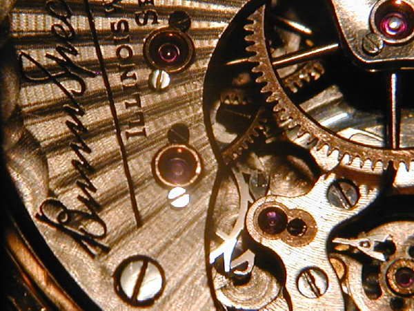

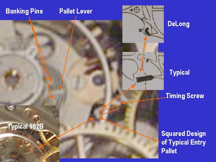

John D. DuvallI enlarged the photo and did some comparisons with a regular 992b and the DeLong drawing. Compare for yourselves:
1. The movement has banking pins. Did the Delong have banking pins?
2. The entry pallet appears identical to a typical 992B (lower left insert)
3. The pallet is squared versus the rounded Delong pallet. Note the jewel I inserted into the photo.
The DeLonger I looked at the photo, the Delonger I believe it's just a typical 992B. If it is a typical 992B, we could always make it run backwards and get at least a grand out of it!

Aaron BereiterThanks John,
I have been seeing that pallet stone all the time and didnt think it was any different either. Hopefully someone will get a hold of "the" watch and photograph it.

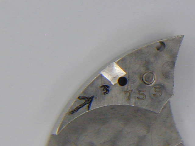

Fred R. Houghamhello everyone,
the easiest way to identify a "delong" is to look at the escape wheel not the balance. you can see this without a loupe or taking the watch apart. the escape wheel teeth are straight not "hooked" on the end. i seriously doubt that this watch is a delong. all of my information states that delong did almost all of his work in the 1920's, far earlier than any "b" movement, and i doubt that the "b" movement could have been modified to accept the delong escapement as a retrofit. also to my limited knowledge none of the delong movements were marked delong. i do have reason to believe that the movements that were actually assembled by delong ( not retrofitted) were marked on the under side of the plates.

Fred R. Houghamescapement pictures
July 23, 2003, 10:53
Fred R. Houghamplate markings

Mike NardickThanks All for the info, But I know what I seen in my hands on Monday.
It's my ears that dont work, NOT my EYES!

John D. DuvallFred,
Good pictures of the DeLong mod. Unfortunetly all I had to go by was the picture Mike posted of the 992B. We weren't looking at or interested in the balance wheel at all.
The problem is that 992B's have such a large pallet bridge, it's hard to see anything under or around it. I was looking hard for the escape wheel teeth but just couldn't make any out. So I had to go with what I could see in the picture.
We were aware from the earlier DeLong sketches of what to look for. The only problem is that the picture lacked detail in that area.
About the only thing you can make out in Mike's picture is the entry pallet, pallet lever and banking pins. The critical areas were either shaded or blocked by balance screws. I should have stretched my arrow a little further on the insert. I was pointing to the entry pallet on that movement as well, not the balance. I labeled and pointed to the balance screw only to indicate what it was in the picture and not to be confused with some other component.
Guess we will know for sure after the 3rd. Dang it, I need to keep my nose out of Hamiltons and keep it buried in Elgin's!
