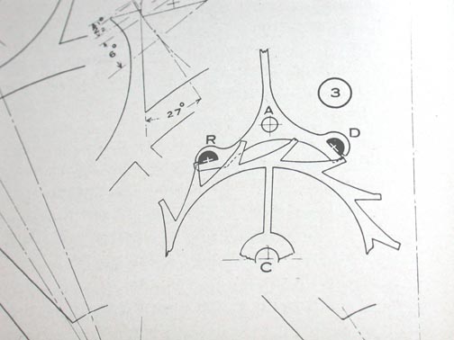

in the early 'teens' Charles DeLong devised an escapement with upright round pallets. In short, the escapement was more efficient in theory, allowing a weaker mainspring to be used.

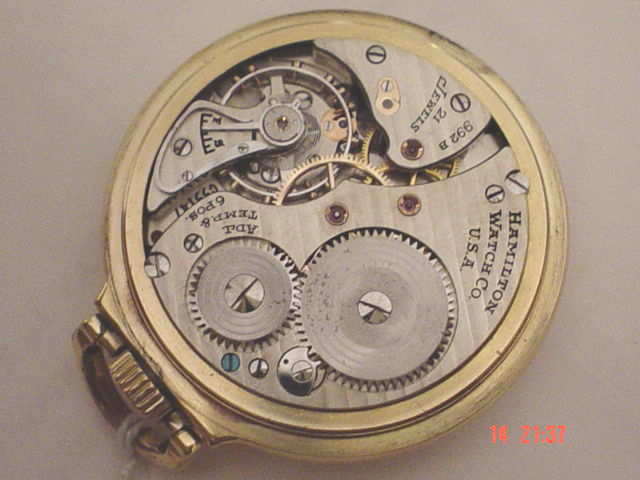

Mike NardickSerial Number is C-55147
July 18, 2003, 22:12
Mike Nardick.
July 18, 2003, 22:13
Mike NardickANOTHER GREAT WATCH HE BOUGHT......
July 18, 2003, 22:35
Aaron BereiterMike,
That watch dosent appear to have the upright pallets.
I have never seen a Delong but that dosent look like they are described. I believe I can see the pallet stone and it dosent look any different to me.
July 18, 2003, 22:45
Terry Hillcannot tell at that angle...
would be interested in case serial number and markings....
July 18, 2003, 23:03
Mike Nardickcase serial number is 4741160 and is marked both star and Hamilton. in the book it is called a model 16

Harold VisserThe best way way to determine the escapement type is to just look and see if the pallet fork has upright pallet jewels that resemble roller jewels in shape,i.e. round with a flat side like the picture shows.
Harold

Aaron BereiterMike,
I just dont see any difference in the photos compared to a regular 992b.
I'm just waiting for Ed, Terry or somebody to give an expert opinion. The pallet stones look conventional to me.

Lindell V. RiddleEveryone
I spoke with John Moeller for over an hour. He appears to be an open and friendly guy who is trying to figure out exactly what he has. At this point, there is no conclusive evidence as to whether he does or does not have a 992B with DeLong escapment. Apparently there is something unusual about this particular movement. The only way to be certain will be to remove the balance bridge and photograph the pallet fork and any other applicable details.
On Monday John is intending to ship the watch to me and when it arrives we will get to the bottom of the situation. I will bring in Watchmaker Rich Kuhn for the examination. Rich will assist me in determining what the watch is or is not. We will do our best to take sharp, clear images. Once we have the images they will be made available for everyone to see on our Chapter 185 Discussion Site and sent to several noteworthy experts for further evaluation.
Stay tuned for further developments!
UPDATE... By now you probably know the watch was never shipped to us for evaluation and the imaginary "DeLong" came up painfully short. We will always follow up on reported sightings, but we will also remember that skepticism is a very healthy thing to have.

Phil DellingerIn the Shugart Price Guide to Watches NO. 22 on page #271 there is a side by side comparison of the standard escapement and the DeLong escapement. In the Price Guide to Watches NO. 23 the comparison is shown on page #273. These examples clearly show the difference and what to look for. Hope this helps to identify the 992B.

Mike NardickI seen the watch in person today, I'm by far NOT an expert, but it matched up to all the pics. It is Delong, It will be at the 37 mart/meeting on the 3rd.
