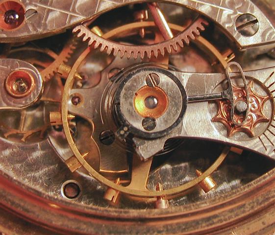

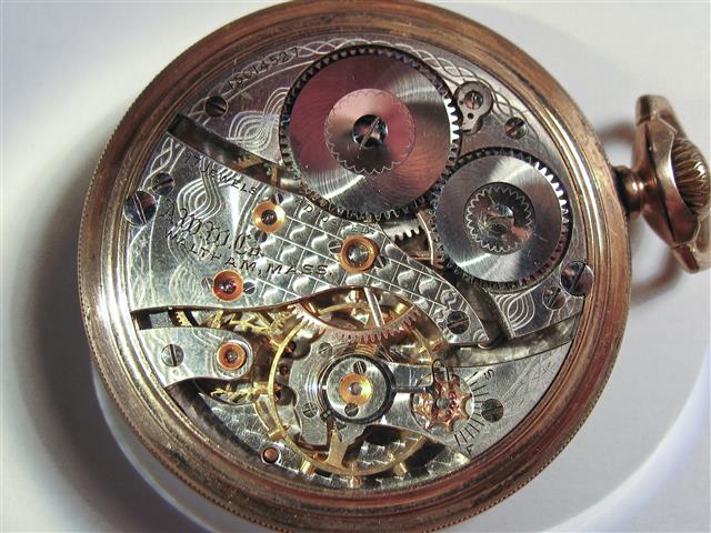

I recently acquired this Waltham watch. It's a model1899, 16s, grade 630 from ~1906. Does anyone notice anything amiss????
May 21, 2013, 22:59
Eric Unselt
It looks like the click pin is missing.
The hairspring appears white, which is unusual.
May 21, 2013, 23:06
Eugene Buffard
Solid balance, White hairspring.
May 21, 2013, 23:12
Kevin Moodie
You have it, It has a new replacement ?conel balance.
May 22, 2013, 10:15
"Veddy Interesting" . . . Has it been converted to Double Roller?
May 22, 2013, 13:00
Kevin Moodie
Without talking the balance out, it sure looks like a single roller through my microscope.
