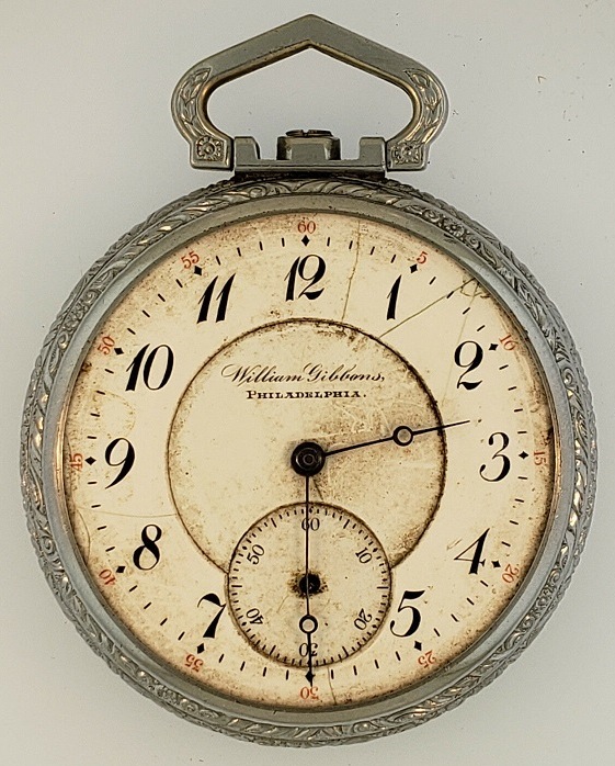

Robert Lewis Van VurenWill replacing this Illinois private label dial be good or bad

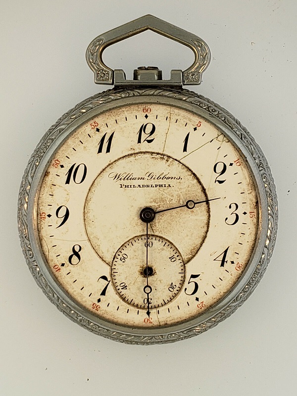

All,
I picked up a William Gibbons Illinois 117 RR grade only 220 made. I have a NOS case and hands.
I would like to know if replacing the private label porcelain dial with a mint Illinois dial will affect the value?
Best regards
RLVV
January 29, 2019, 21:27
Claude GriffithMy take would be to get some denture toothpaste and a soft bristle toothbrush and do an initial cleaning. Then get some polydent type tablets and soak the dial, sometimes if the hairlines are dirty I use some type of foaming cleaner for tubs and such.
Private label dials set the watch off from the typical look but in the end it is a judgement call. I see mostly hairlines but no chips or missing pieces.
January 29, 2019, 21:44
Tom DunnRobert; If movement is mkd same as dial you should keep the dial. Like Claude said, I too think that dial should clean up pretty good. Show us a pic of the movement
January 30, 2019, 13:43
Edward KitnerI agree with Tom, clean it and keep it!
I and others here have used
Comet liquid/spray bottle type with great success.
I think you will be surprised with a cleaning!

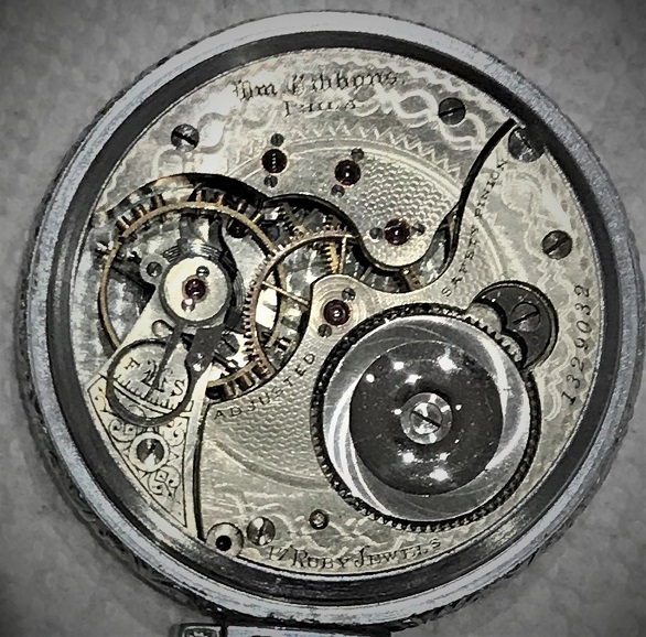

Robert Lewis Van VurenHere is a picture of the back and it has the private label name on it.
Best Regards
RLVV

Roger StephensRobert,clean the dial. I think you will be pleased.

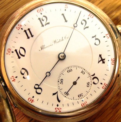

Claude GriffithSee how the current hands clean up, on PL fancy types moon hands were not unusual and look at some photos and see what the proper second hands his, I would think a thin, non bold type.Below is an example of a Getty type.
http://s.ecrater.com/stores/84...155386a6f_84347b.jpgJanuary 31, 2019, 19:11
Tom DunnKeep those moon hands on Robert. They were probably original as Claude says. That second hand he showed you will work About anything except a bunn type with the spear that wouldn't be correct

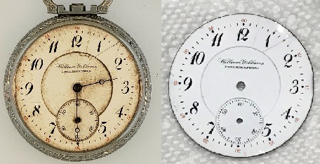

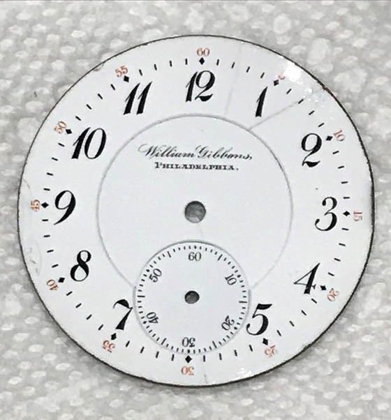

Robert Lewis Van VurenWell this is what it looks like so far. I think I need to get the liquid Comet and soak it in that.
Thanks everyone for all of your help.
RLVV

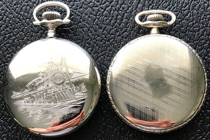

Robert Lewis Van VurenAll,
What case should I use the one on the left or the NOS on the right?
Best regards
RLVV

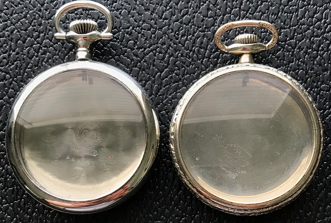

Robert Lewis Van VurenThe back
RLVV

Dave TurnerDial looks good!
I'd use the one on the left, FWIW.

Claude GriffithI agree with Dave the longer pendant is more time correct and how can you go wrong with a choo choo on the back

Eugene BuffardWhat you have is a grade 177.
Very rare great find. I agree with the other members.
I added it to the 177 grade data base in the Illinois section.

Robert D. MillerCould you post a couple of more "before and after" pictures of the dial after cleaning? It looks like it is really improved.
I have a couple of older Elgin porcelains that need cleaning, and I'm looking for what is considered the "Best" method that has the least potential for damage.

Kevin Hoffmangreat job Robert ! I did a search on this site and there are a dozen pages on dial cleaning , the comet seems like the best

Robert Lewis Van VurenHello Robert D,
B4
RLVV
February 08, 2019, 02:29
Robert Lewis Van VurenAfter
RLVV

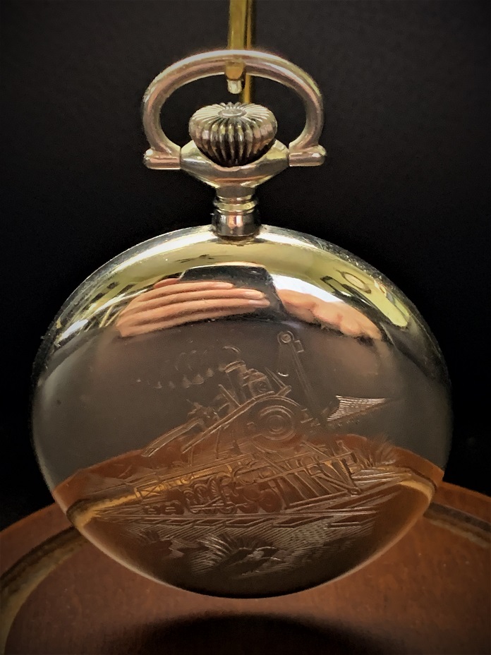

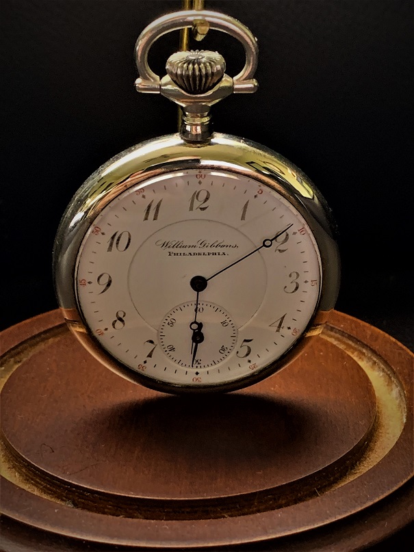

Robert Lewis Van VurenFinished
RLVV
July 06, 2019, 02:08
Robert Lewis Van VurenBack
RLVV

John ScottRobert, you really have done the right thing by that beautiful watch. Congratulations and thank you for showing.
July 09, 2019, 00:24
Robert,
John said it well, you did it right and SAVED a very worthwhile example.
Truly a NICE combination!
