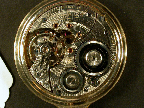

Here is another oddball. I am assuming this is a case of a balance cock switch If not, I have a very rare watch. The movement number is 5569289.
I have never seen one with Elinvar in two places.

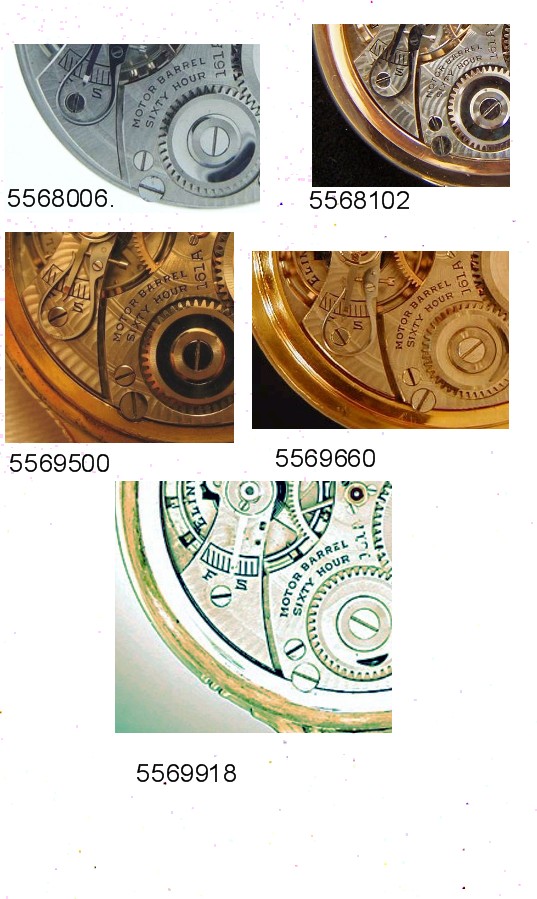

As the run is from 5,568,001 -5,570,000 here is some other movements from that run.
P.S I don't own these movements.

Not my specialty, but the damasceening doesn't seem right on your balance cock either.
