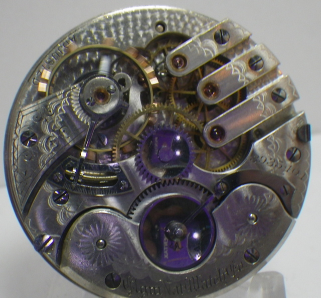

I picked these 2 movements up this weekend. A Elgin convertible. and a Center Seconds.

Will the Convertable need a special case.
I know the 14sz Doctors watch will need a special case. Any one have one.

I have a 3fb convertible like that one in a silveroid case so I dont think it needs a special one.

If the convertible is in an open face case , it will need to have a lever cut at the 23 minute mark.
Also the back must be high enough to let the setting gear to rise,to set time, (usually not a problem).
Nice watch!!
